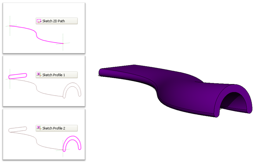

About swept blends
   The Swept Blend tool allows you to create a blend that has 2 different profiles and then sweep it along a path. The shape of a swept blend is determined by the 2D path you either sketch or pick and the 2 profiles you either sketch or load.
The following procedure is a general method for creating a swept blend. Steps may vary depending on your design intent.

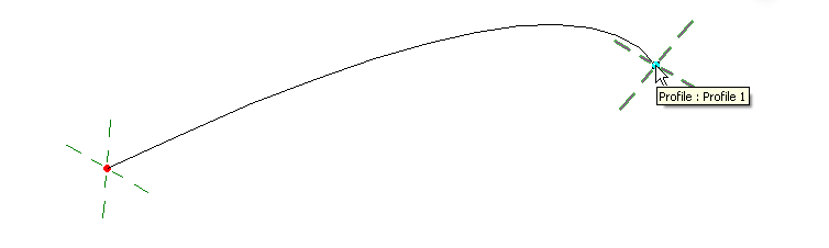

- Specify the path for the swept blend.
Note: If necessary, set the work plane before you sketch or pick the path for the swept blend. Click Create tab
Work Plane panel
 (Set).
  Do one of the following on the Modify | Swept Blend tab
Swept Blend panel:
  - Click
 (Sketch Path) to sketch a path for the swept blend.
- Click
 (Pick Path) to pick existing lines and edges for the swept blend.
- Sketch or pick the path.
To select edges of other solid geometry, such as extrusions or blends, click Pick Path. Or pick existing sketch lines, watching the status bar to know what you are picking. This method of picking automatically locks the sketch lines to the geometry you are picking and allows you to sketch the path in multiple work planes, hence allowing for a 3D path.
  Note: A swept blend path can only have one segment.

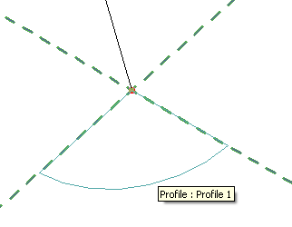

- Load or sketch Profile 1.
The end point for Profile 1 on the swept blend path is highlighted.
