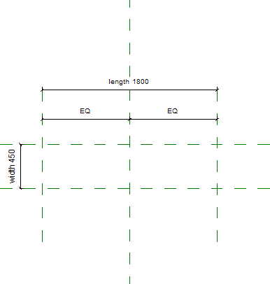

After you dimension the family framework, you label the dimensions to create parameters.
For example, the dimensions below have been labeled with length and width parameters.
