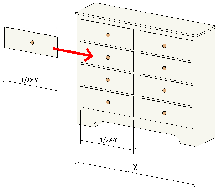

- A chest of drawers has drawers as nested family. The Width parameter of the chest family is passed to the nested drawer family, to allow it to fit correctly in the chest opening.
