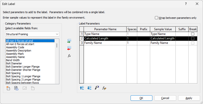

You assign single or multiple parameters to labels with the Edit Label dialog.
The Category Parameters window contains the label parameters related to the tag type. The Label Parameters window contains the Category Parameters that display in the label. Typically, this is a single parameter, but you can detail more complex, concatenated labels.
