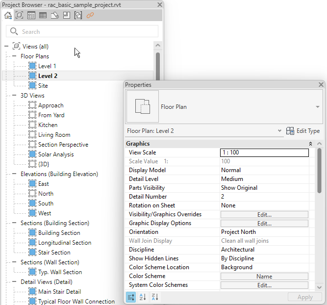

A docked window shares one or more edges with adjacent windows and toolbars. If a shared edge is moved, the windows change shape to compensate. You can also float windows anywhere on the screen or
move them to another monitor.
An undocked window is one that has been separated from the application window. Each undocked window can be moved around the screen or screens as desired. Undocked windows can be resized and grouped.

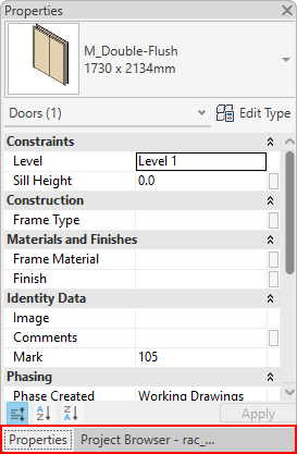

Grouping windows
A window group is a way to have more than one window occupy the same amount of space on the screen. When windows are grouped, each window is represented by a tab at the bottom of the group. In a group, click a tab to display that window. You can group or ungroup windows as necessary.
Note: You can group windows of the user interface (such as the Project Browser and the Properties palette), and
you can group views, but you cannot create a group that contains both user interface windows and views.
In the following image, the Project Browser and Properties palette are grouped. Notice that the Properties palette is the active tab.

Important: When moving dockable windows, it helps to pay attention to the cursor position and the visual cues. For example, say that the Project Browser and Properties palette are currently undocked and you want them to be stacked and docked on the left. To dock the Project Browser on the left, position the cursor in the title bar, and drag the window until the
cursor is touching the edge of the
Revit LT interface on the left. The outline of the window gives you a preview. Using the same method, drag the Properties palette. Position the cursor on the lower edge of the title bar of the docked Project Browser, and notice in the preview of the window that the palettes will stack one above the other. (If you position the cursor within the title bar however, above the lower edge, the palettes will display as overlapping tabbed windows.)
