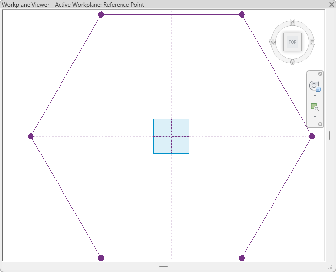

The sample images in the following procedure use this sweep as the starting point:
To edit with the Workplane Viewer
Work Plane panel
The Workplane Viewer opens to the appropriate 2D view zoomed to the extents of the model.

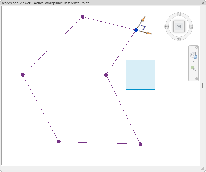

When you make changes in a project view or in the Workplane Viewer, other views are updated in real time.
