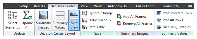

Use the Decision Center tab to compare results from multiple scenarios:
- Ensure the Summary Items for all selected scenarios are current with Update.
- Control the appearance of the Decision Center with Decision Center Layout.
- Capture graphical and tabular data with Save.
- Quickly add or remove all thumbnail images to the Design Review Center with Summary Images.
- Plot Summary Value data and control which result quantities are listed in the output table with Summary Values.
