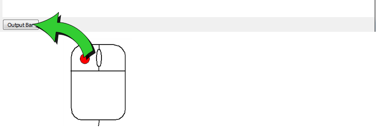

Collapsible Output bar
When viewing results, it is useful to hide the Output bar to maximize space on the Graphics window:
output bar

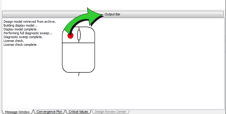

To expand the Output bar:
expand output bar
