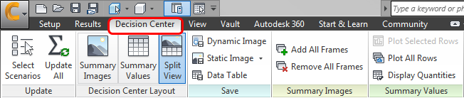

Decision Center
After capturing Summary items, compare them in the Decision Center. To open the Decision Center, click the Decision Center tab:
decision center tab

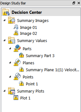

The Decision Center appears in the Design Study Bar:
design study bar
Updating Summary Items
The following symbol means that a Summary item either has not been mapped to the other scenarios or that the results have changed since the last time it was mapped:
warning icon

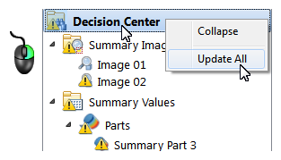

To update the Summary item, click Update All from the Decision Center tab:
update all
Alternatively, right click on Decision Center, and click Update all:
decision center update all
You can update individual Summary items by right clicking on them and selecting the update command.

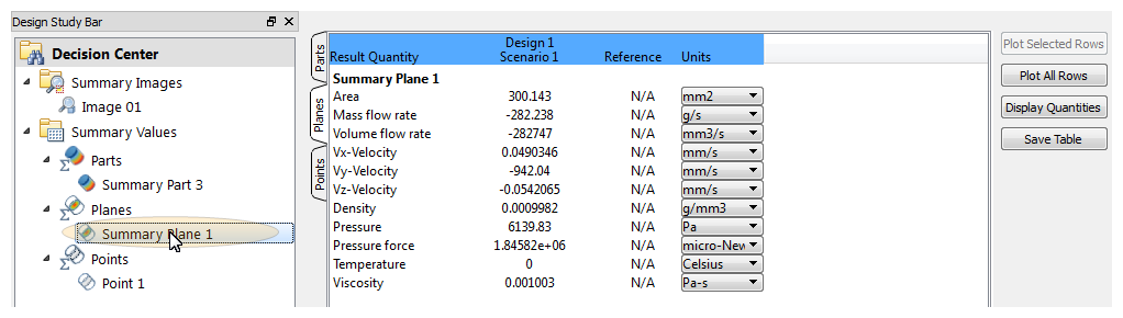

Viewing Summary Values
Use Summary Values to compare data from Summary Planes, Summary Points, and Summary Parts. To view the Summary Values table, click on a summary entity in the Decision Center.
critical values

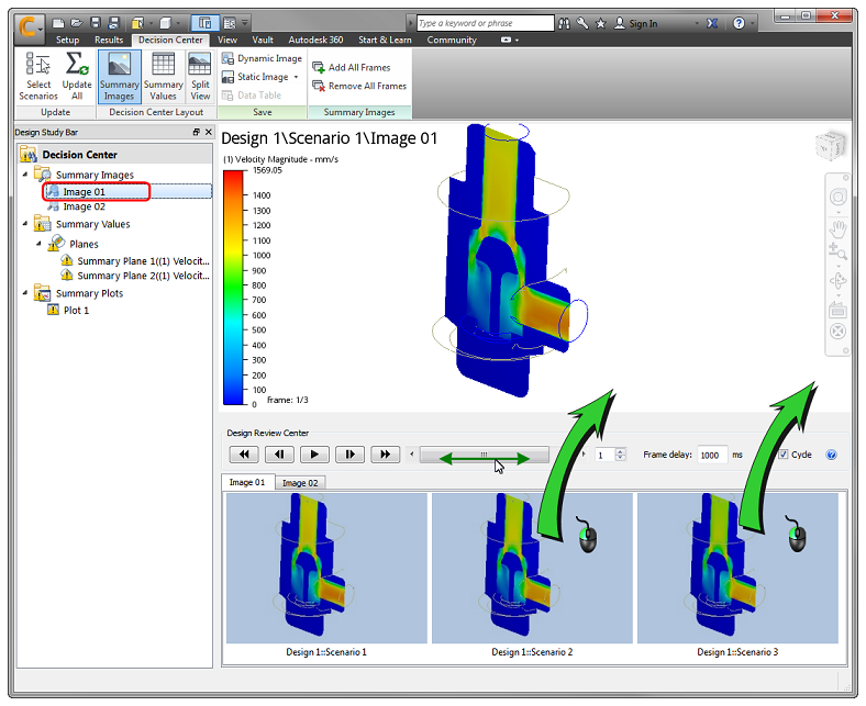

Viewing Summary Images in the Design Review Center
Use the Design Review Center to compare visual data with captured Summary Images. Click the image name in the Decision Center, and the image for each scenario appears in a separate thumbnail image in the Output bar. To add a thumbnail view to the display, drag it into the graphics window.
design review center

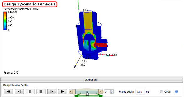

To view multiple images, drag the slider or use the "VCR" controls to flip between each design or scenario:
design review vcr
