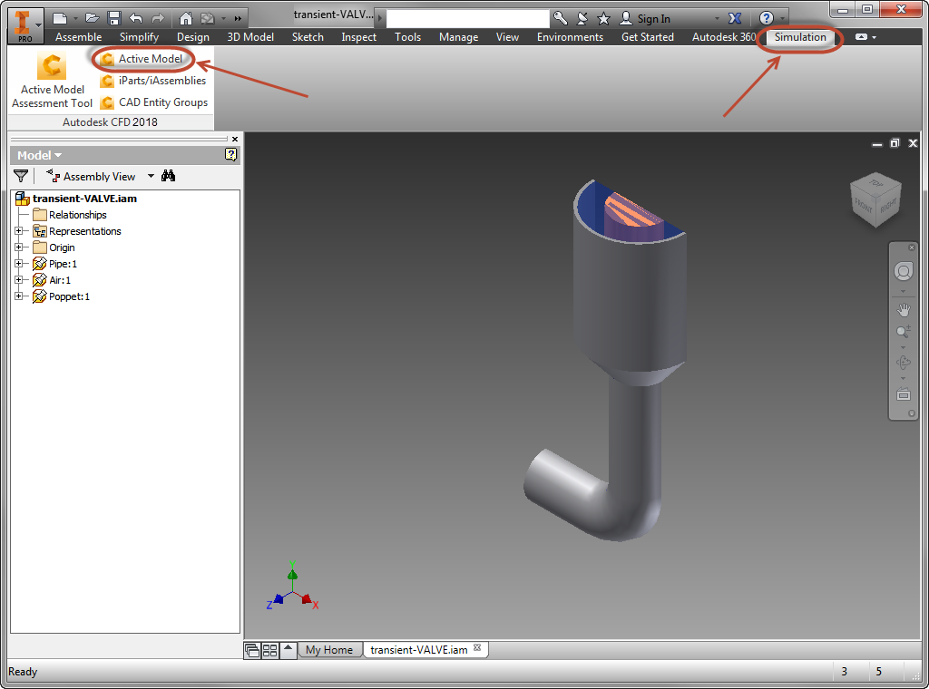

Use this step to launch from Autodesk® Inventor, SolidWorks, PTC® Creo, or UGNX.
Open the Transient-valve assembly from this folder:
Users\Public\Public Documents\Autodesk\CFD 2023\Tutorials\<cad>\transient-valve
Click the command to launch the Active Model.
For example, if you are launching from Autodesk® Inventor, click Simulation and Active Model:
