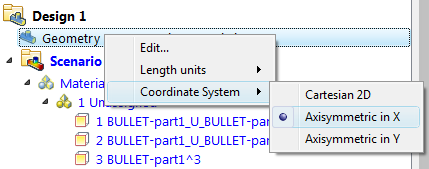

Set the Analysis Coordinate System
This analysis is axisymmetric about the X axis. We will change the coordinate system in the Design Study Tree.
Right click on the Geometry Branch.
Right click on Coordinate System.
Select Axisymmetric in X.
