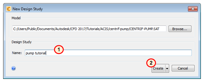

Start Autodesk® CFD from the Desktop or Windows® Start menu:
Click New from the Start & Learn tab:
On the New Design Study dialog, click Browse.
On the File manager dialog, navigate to Users\Public\Public Documents\Autodesk\CFD 2023\Tutorials\<file type>\centrif-pump.
Notes:
Click Open.
Autodesk® CFD starts, and creates the Design Study for the tutorial.
