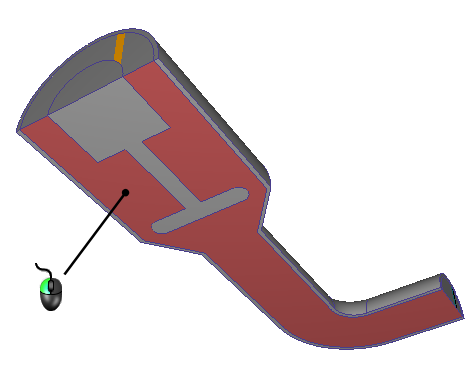

Assign the Symmetry Boundary Condition
Select the Symmetry face.

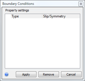

Open the Boundary Conditions quick edit dialog in ONE of the following ways:
- Click Edit from the context toolbar:
- Click Edit from the Boundary Conditions context panel:
Type = Slip/Symmetry
Click Apply.
