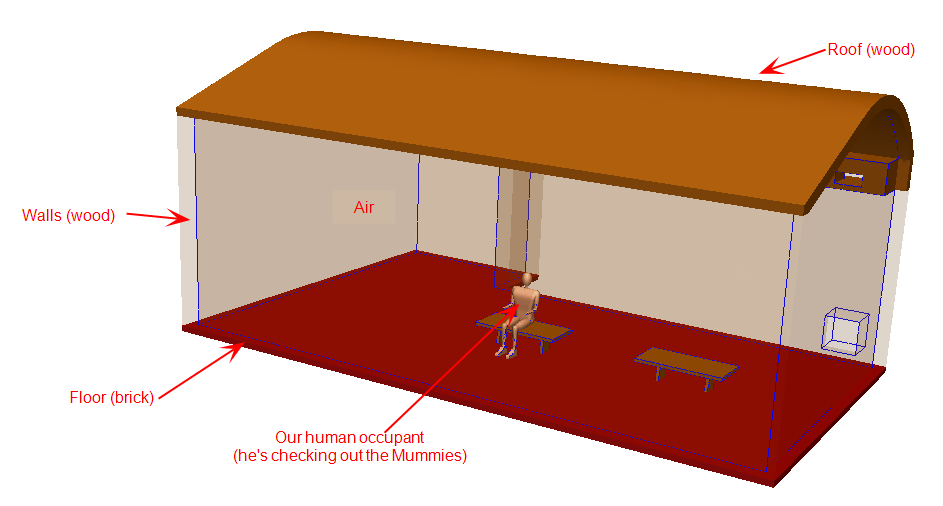

The exhibit hall is an open atrium with insulated walls and roof, a brick floor, two benches, and a human occupant resting on the bench (it's been a long day, and he's checking out the Mummy exhibit while the wife and kids visit the gift shop).
There is also a part for the air that fills the exhibit hall. (We created this in the BIM/CAD model, but it's just as easy to "cap" the openings and let Autodesk® CFD do the work for you.)

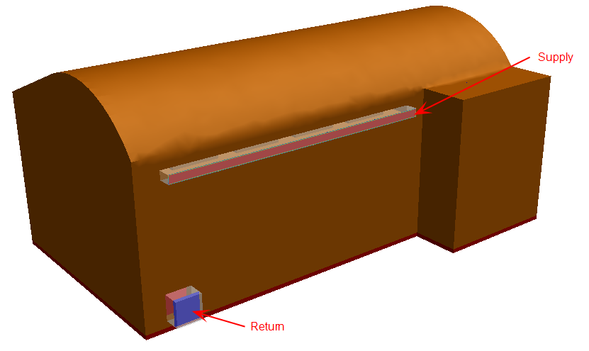

Ventilation air enters through a high-wall supply on the back wall and exits through a floor-level return, also on the back wall:
The back wall is an internal wall shared with another room that is not included in the model.
