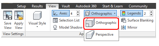

If not, click View > Perspective, and select Orthographic

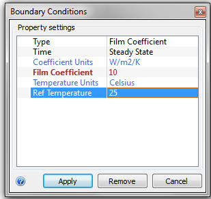

Open the Boundary Conditions quick edit dialog in ONE of the following ways:
Type = Film Coefficient
Coefficient Units = W/m2/K
Film coefficient = 10
Temperature Units = Celsius
Ref Temperature = 25
Click Apply.
