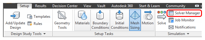

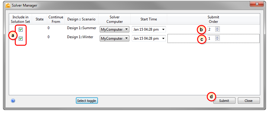

In this step, we solve both scenarios. Instead of manually starting the second after the first is finished, we use the Solver Manager to automatically run them sequentially.
To open the Solver Manager, click Setup (tab) > Simulation (panel) > Solver Manager.
Start the simulations.
Check the Include in Solution Set box for both models.
Change the Submit order for the Summer scenario to 2.
Change the Submit order for the Winter scenario to 1.
Click Submit.

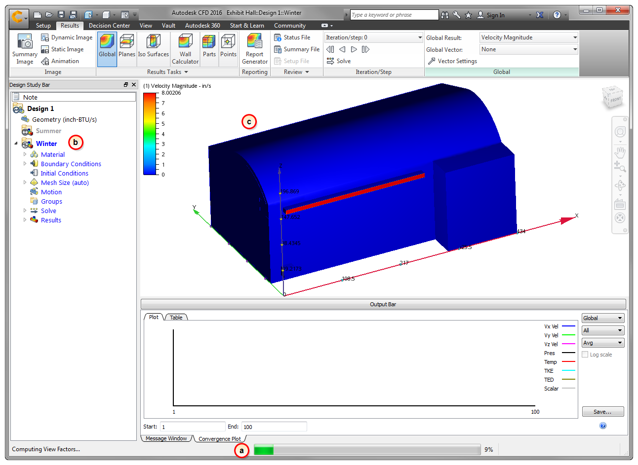

Note that the radiation view factor calculation takes several minutes at the beginning of each simulation.

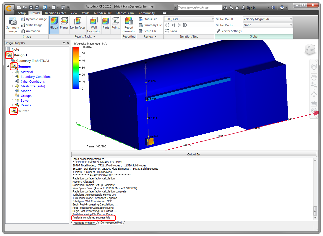

The Design Study bar uses special icons to show the status of each scenario. Note that the "Running" icon appears on the Winter scenario name to indicate that Winter is running. The "Queued" icon appears beside Summer to indicate that the Summer scenario is in the "queue" and will be run next.
Autodesk® CFD displays results as they are computed.

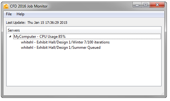

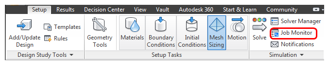

To open the Job Monitor, click Setup (tab) > Simulation (panel) > Job Monitor.

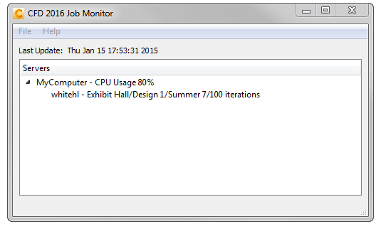

The Summer scenario starts automatically after the Winter scenario finishes. The Job Monitor changes to show this:

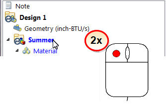

To watch the progress of the Summer scenario, double click on Summer in the Design Study Bar.
If you didn't double click on the Summer scenario in the Design Study Bar while it was running (step 4), you should do it now. (This ensures that the results from Summer are loaded into the display.)
