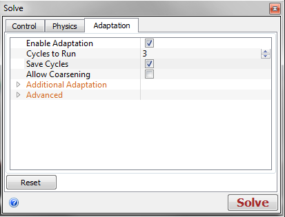

Click Solve from the Setup tab:
Click the Physics tab.
Flow = On
Click the Control tab.
Iterations to run = 100
Click the Adaptation tab.
Enable Adaptation = On.
Cycles to Run = 3.
Save Cycles = On.
Click Solve to start the analysis.

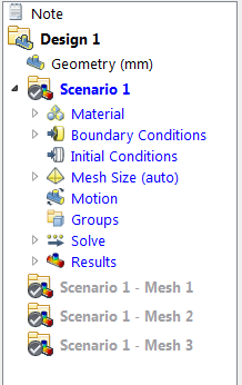

The simulation will run a total of four cycles:
At the conclusion of the design study, Scenario 1 contains the final mesh. Scenario 1 - Mesh 1, Scenario 1 - Mesh 2, and Scenario 1 - Mesh 3 contain the intermediate meshes. The Design Study bar should look like this:
