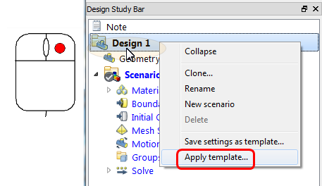

Right click on the Design branch, and select Apply template...

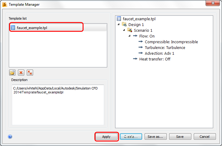

Select faucet_example.tpl, and click Apply.
At the prompt, click Yes.

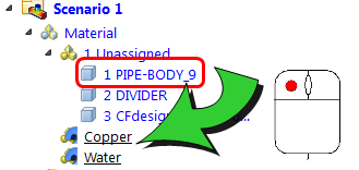

Left click on the Pipe-Body part, and drag onto the Copper material.

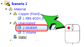

Left click on the Divider part, and drag onto the Copper material.

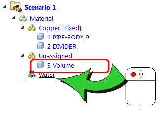

Left click on the Volume part, and drag onto the Water material.
