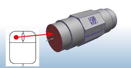

Select the inlet.
select inlet

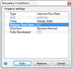

Type = Volume Flow Rate
Unit = m3/min
Volume Flow Rate = 0.2
volume flowrate
Click Apply.
