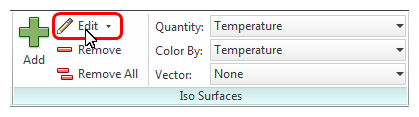

1. Click Iso Surfaces on the Results tab:
2. To create an Iso Surface, click Add on the Iso Surfaces context panel:
Note: This is a good time to rotate the model to see more of the front...
3. Click Edit from the Iso Surfaces context panel.

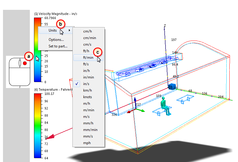

5. The default units of velocity magnitude are in/s. Let's change them to ft/min...
- a. Right click directly on the Velocity Magnitude legend (as shown below).
- b. Click Units.
- c. Select ft/min from the menu.
Note: This helps to view the velocity results using units that are a little more standard in the industry.

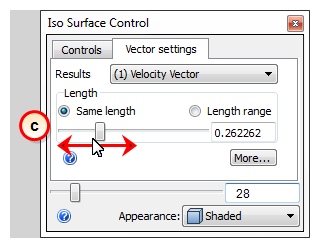

7. Display vectors on the iso surface:
- a. Click the Vector settings tab.
- b. Select Velocity Vector from the Results menu.
- c. You may need to adjust the vector length to see them better. Make them bigger by dragging the Length slider to the right; smaller by dragging to the left:
Note: The model should look like this, but may be slightly different:

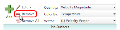

9. Because the summary image is saved, we can delete the iso surface. Click the Remove on the Iso Surfaces context panel.
Note: In this step we created an iso surface using velocity as the iso quantity and colored it with temperature results. You can also learn a lot about the thermal performance by using temperature as the iso quantity. This shows areas that are the same temperature, and are really useful for identifying temperature and airflow trends.
