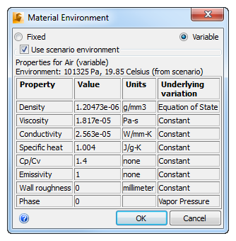

Select the part.
Open the Materials quick edit dialog in ONE of the following ways:
On the Material quick edit dialog, Type = Fluid
Name = Air
To allow the air properties to vary with pressure, click Set... on the Environment line. On the Material Environment dialog, select Variable, and click OK.
Click Apply.
