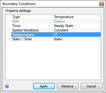

Click Boundary Conditions from the Setup tab:
To show all parts, press Ctrl while middle-clicking in the graphics window, but off of the model.
Select the four sides and the top of the air environment.
Open the Boundary Conditions quick edit dialog in ONE of the following ways:
Type = Temperature
Units = Celsius
Temperature = 25
Click Apply.
