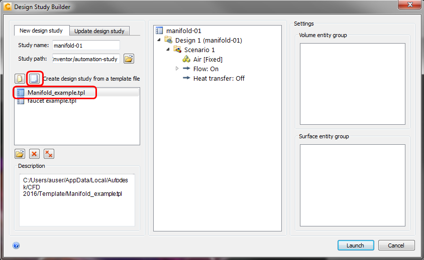

In this step, we select which of the CAD designs to include in the design study, and open the Design Study Builder.

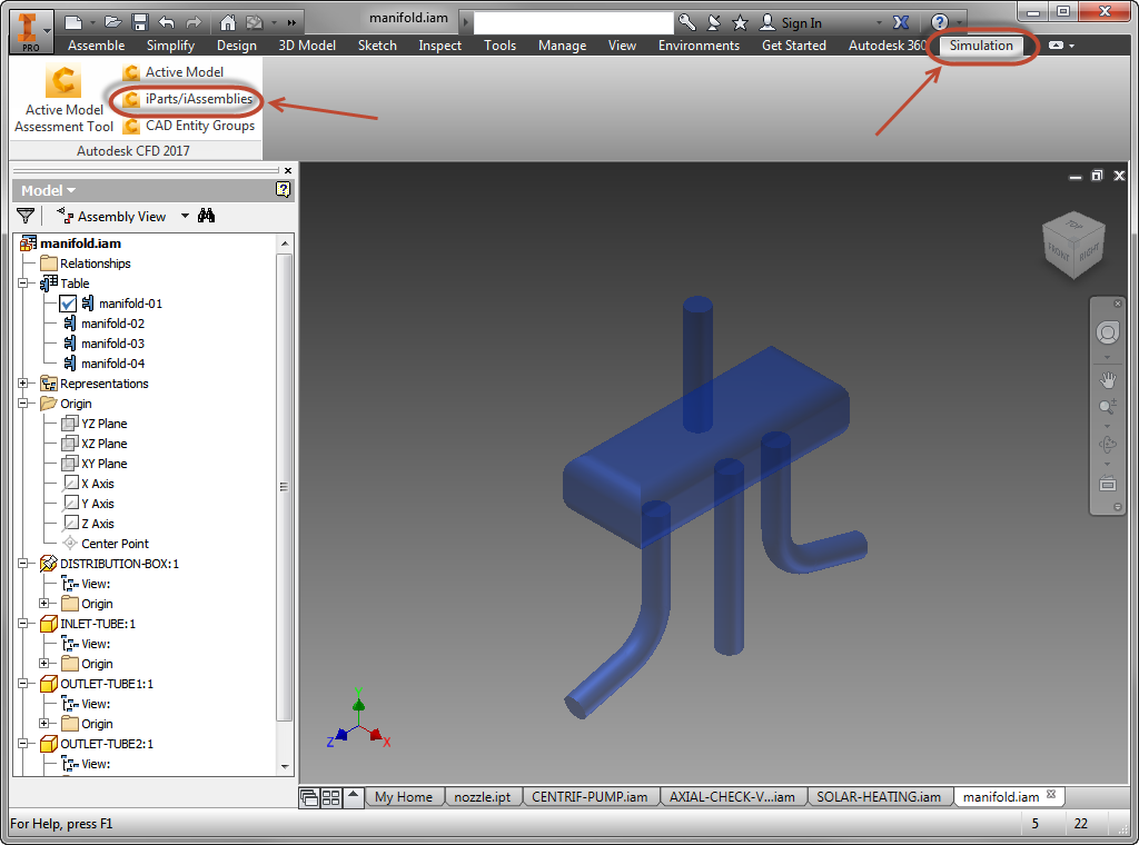

Click the command from the Autodesk® CFD ribbon or menu to launch the design suite:
In Autodesk® Inventor, click Simulation and iParts/iAssemblies:
In Solid Works, click Multi-Configurations.
In PTC Creo, click Launch Instances.
Select the four designs, and click Launch.
Click the Create from Template icon, and select Manifold_example.tpl.
