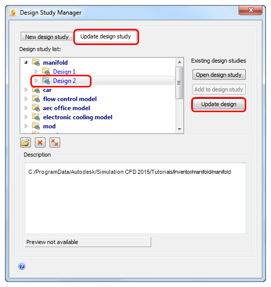

Launch into Autodesk® CFD using the appropriate tool button or menu item.
On the Design Study Manager, click the Update design study tab, and select the new design in your design study:
Click the Update design button.
The geometry for the second design is updated. The middle outlet should be missing:
