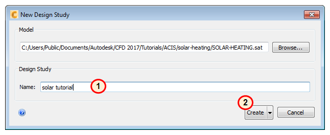

On the New Design Study dialog, click Browse.
On the File manager dialog, navigate to Users\Public\Public Documents\Autodesk\CFD 2020\Tutorials\<file type>\solar-heating.
Click Open.
Autodesk® CFD starts, and creates the Design Study for the tutorial.
