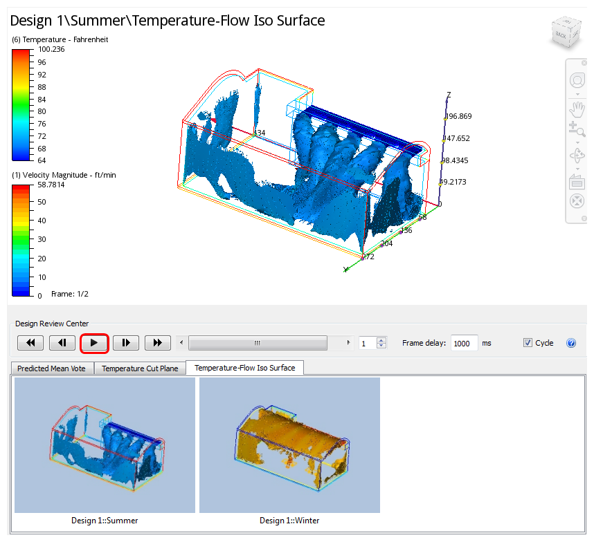

In the previous step, we looked at the temperature through the middle of the hall, and saw some pretty significant differences between the Summer and Winter scenarios. In this step, we'll use the iso surface summary image to better understand the interaction between the flow and temperature.

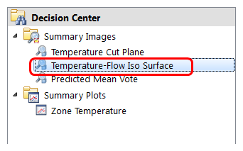

1. In the Decision Center, left click on Temperature-Flow Iso Surface.
2. Compare the results by clicking the Play button.
3. While the images are playing, rotate the model to view the hall from different angles.
