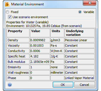

On the Material quick edit dialog, Type = Fluid
Name = Water
To allow the density to vary, click Set... on the Environment line. On the Material Environment dialog, select Variable, and click OK.
Click Apply.
