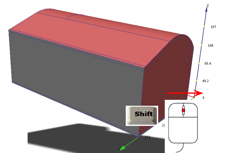

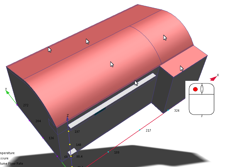

1. Rotate the model so you can see the surfaces of the roof.
(To rotate, hold the Shift key, press the middle mouse button, and move the mouse.)
2. Select the six surfaces of the roof.

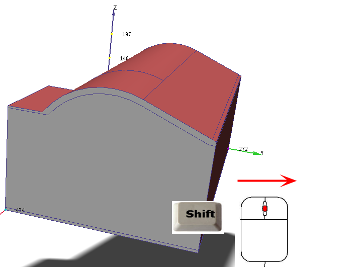

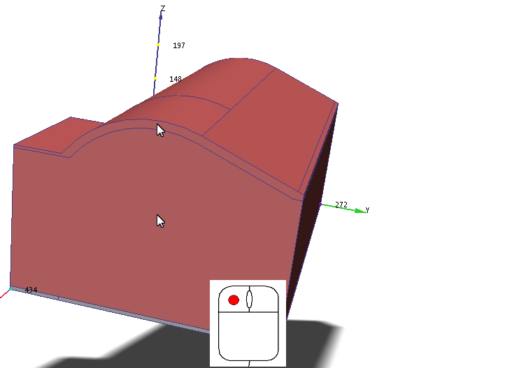

3. Rotate the model so you can see the surfaces on the left side.
4. Select the two surfaces on this side.

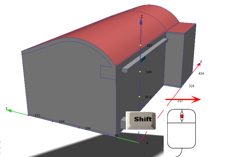

5. Rotate the model so you can see the surfaces on the front side (opposite the supply and return) of the hall.
6. Select the two surfaces on this side.

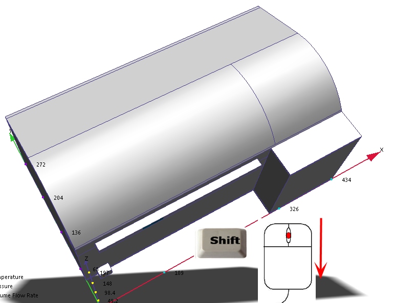

7. Rotate the model so you can see the surfaces on the other small side.
8. Select the final two surfaces.

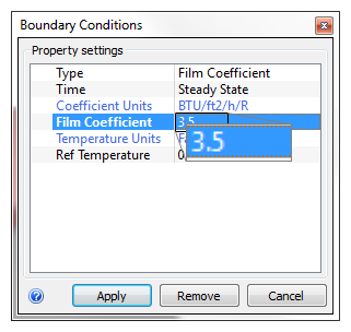

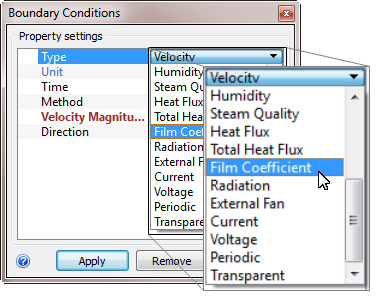

9. Click Edit from the Boundary Conditions context panel:
10. On the Type row, select Film Coefficient.

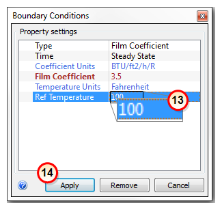

11. On the Unit row, make sure BTU/ft2/h/R is selected.
12. On the Film Coefficient row, enter 3.5.
13. On the Ref Temperature row, enter 100.
14. Click Apply.

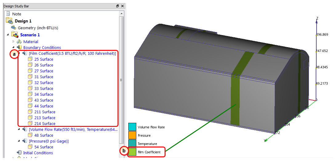

What it should look like...
15. To verify that the film coefficient boundary condition is correctly applied to the exterior surfaces, check the Design Study Bar and the colored stripe on the surfaces:
