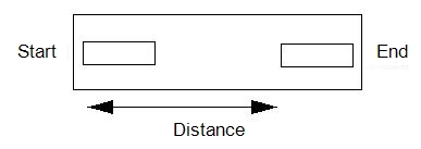

Reciprocating
This method causes the object to oscillate linearly along a prescribed distance, in a specified time.
The Half Period Time is the time it takes the object to move from the start position to the end of the stroke.
The Distance is the length of the stroke:
