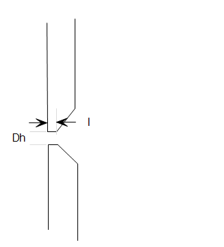

The relationship between loss coefficient, K, and free area ratio, FAR, is given as:
Note: This equation is valid for flow with Reynolds number greater than 105. The ratio of the flat portion of the hole length, l, to hydraulic diameter, Dh, is between 0 and 0.015:
