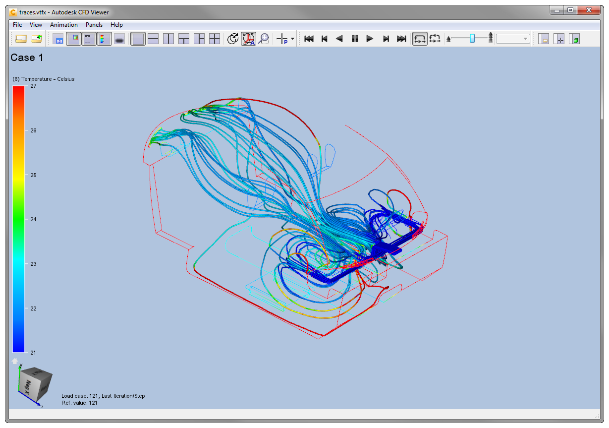

Main Window
The Autodesk® CFD Viewer is shown with a results set loaded:

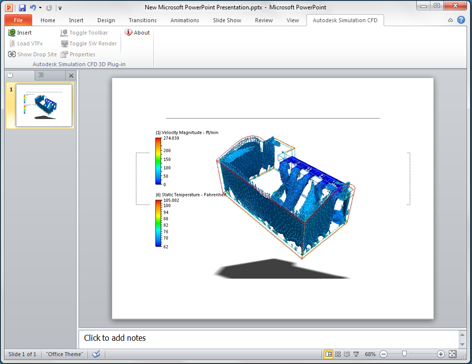

Microsoft® Office Add-Ins
The CFD 3D Viewer has connections to Microsoft® PowerPoint and Microsoft® Word. These enable Dynamic Images to be a part of your Office presentations and documents.

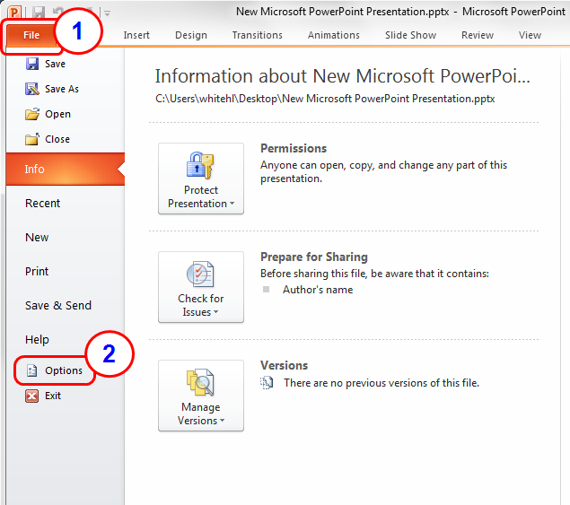

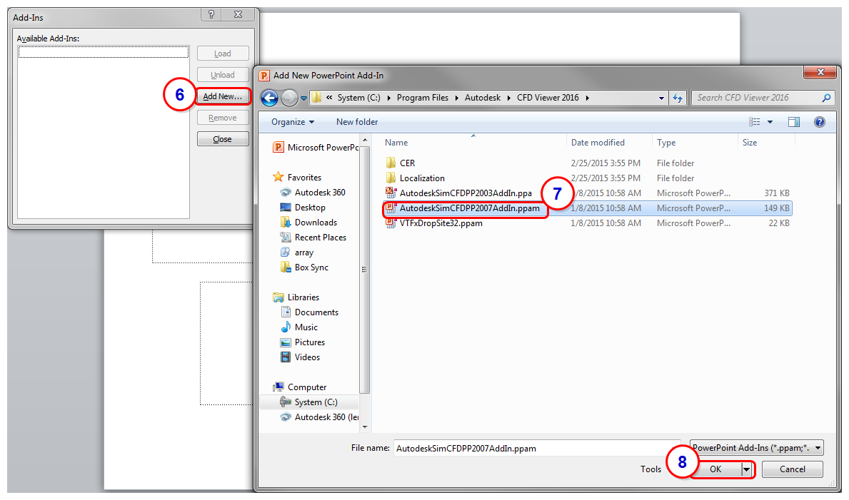

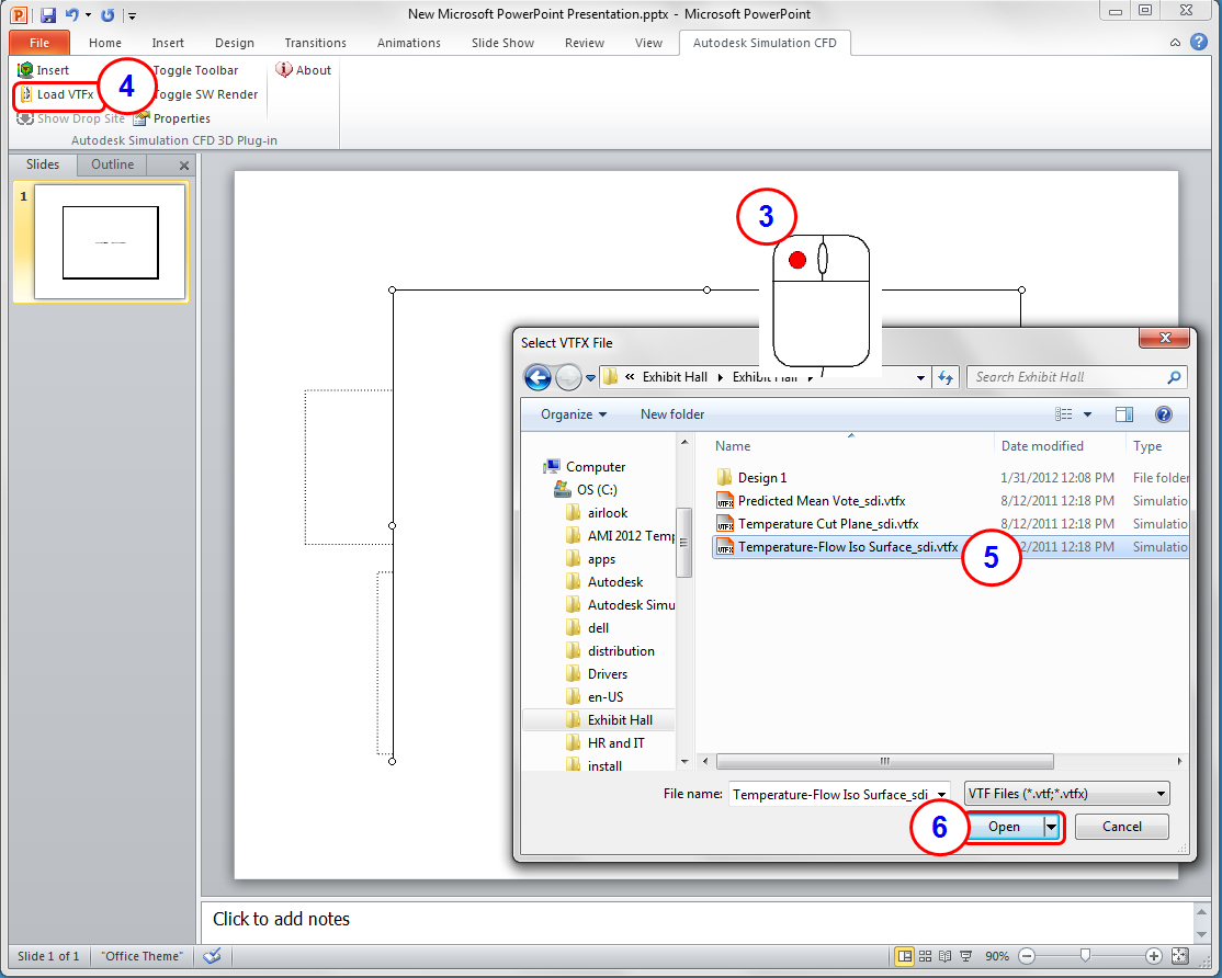

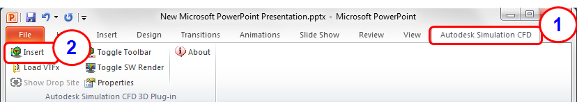

PowerPoint

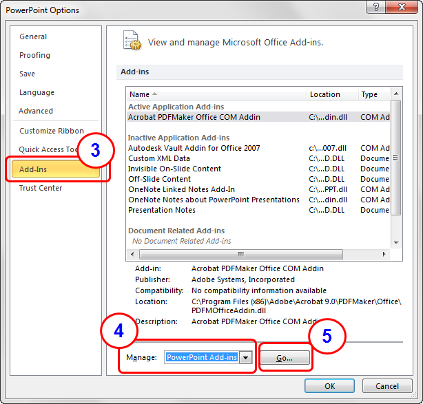

To add the CFD Viewer Addin
Before adding a Dynamic Image for the first time, add the CFD Viewer AddIn:
If the button does not appear, reduce the PowerPoint security settings:

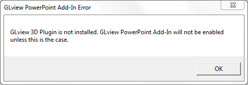

If you see the following error, the required plug in is not installed on your computer:
Note: If you attempt to insert a dynamic image after receiving this error but before downloading and installing the plugin, you may see a "Microsoft Visual Basic" crash message.

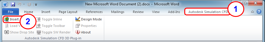

To add a Dynamic Image

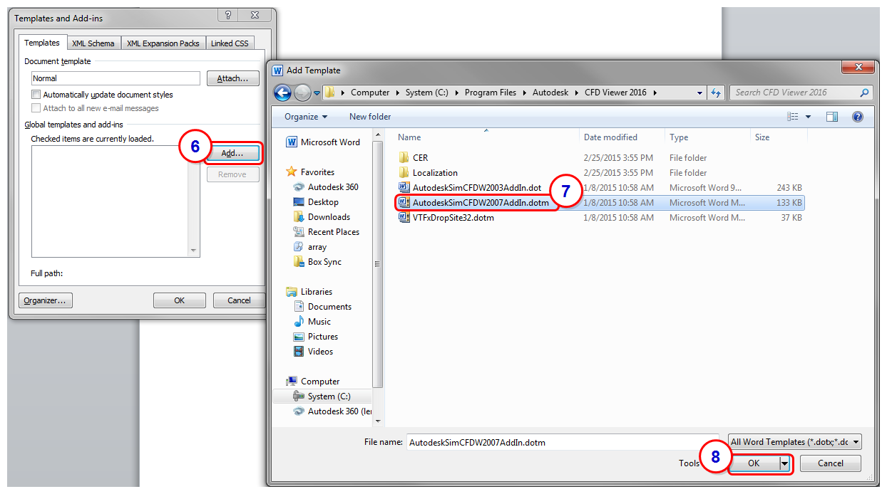

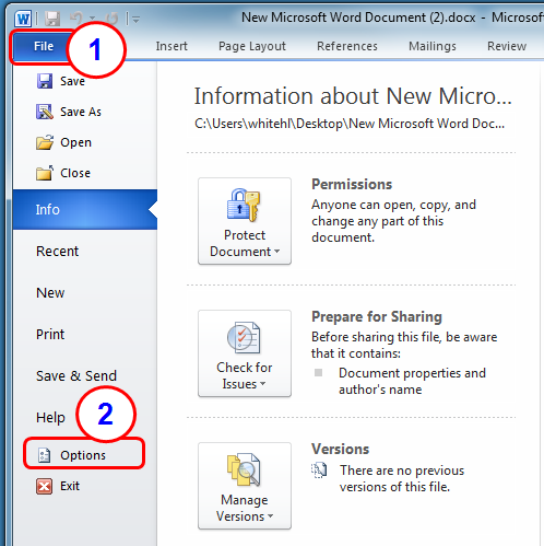

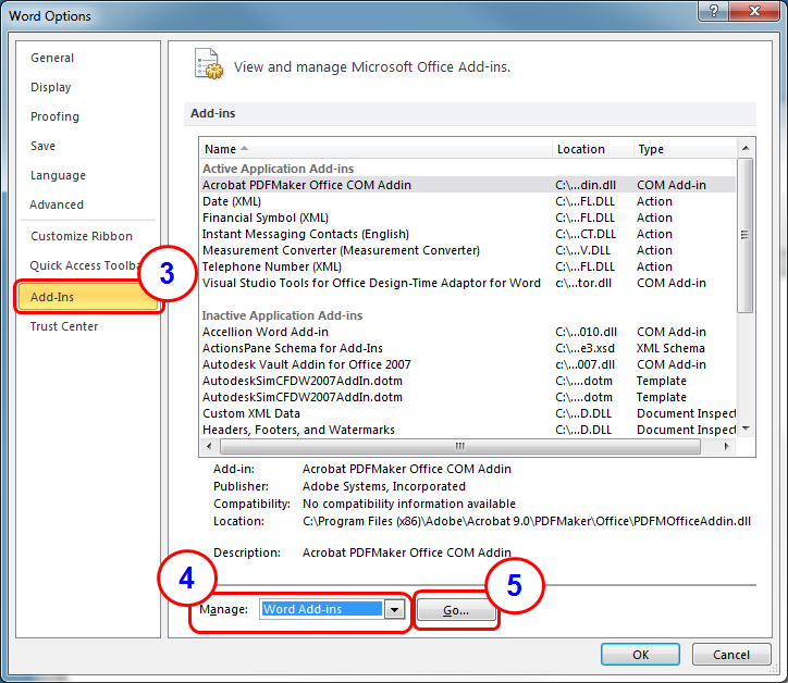

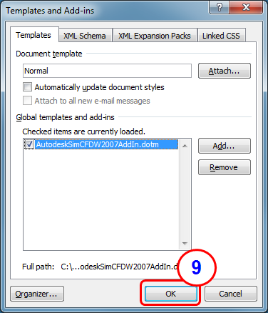

Word

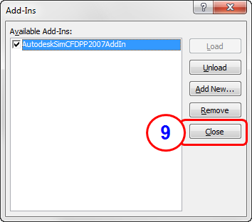

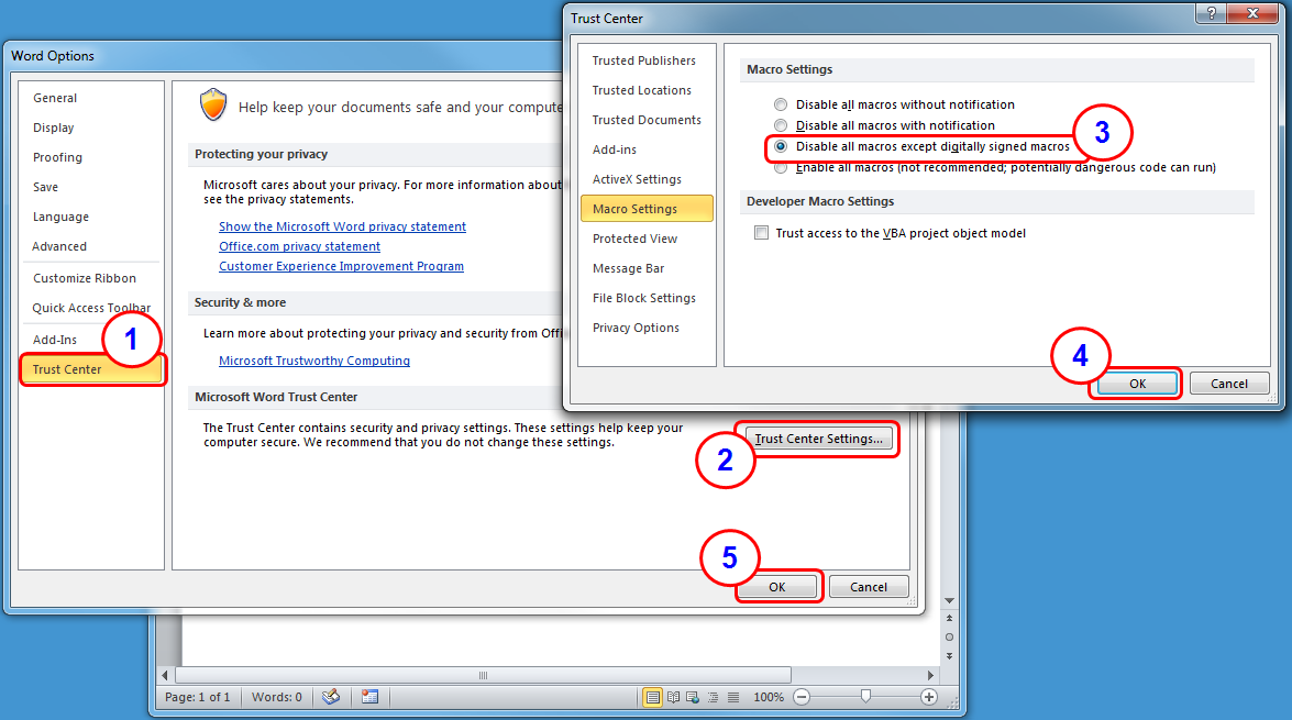

If the button does not appear, reduce the Word security settings:

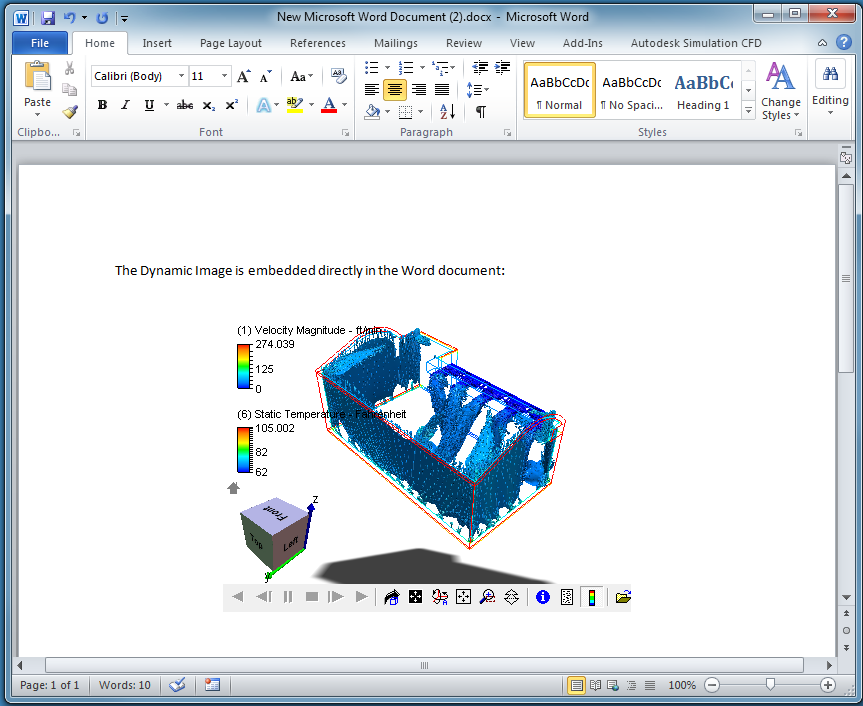

To add a Dynamic Image in Word
