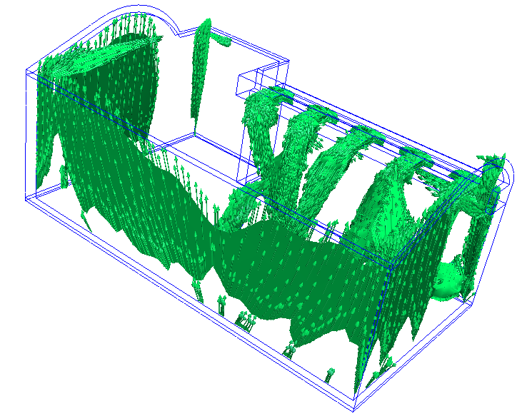

An iso surface is a surface of constant value. This is an example of a velocity magnitude iso surface colored by static pressure. The iso-surface shape indicates everywhere in the model that has a specific velocity magnitude. The colors indicate the static pressure at these locations.
Iso surfaces are a three dimensional visualization tool that show a value as well as the physical shape of the flow characteristics. They are useful for visualizing velocity distributions in complicated flow paths as well as temperature distributions in thermal simulations. You can also use iso surfaces to determine the locations of the maximum and minimum values of a quantity.

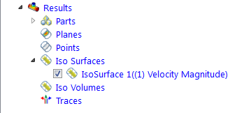

To select an Iso Surface
- On-model: Left click directly on the iso surface.
- Off-model: Click its name in the Design Study bar.
To Hide an Iso Surface
- Uncheck the box adjacent to the Iso Surface in the Design Study bar. You can also right click on the name, and click Hide iso surface.

Vector Settings Controls
To enable vectors or to change the vector quantity
On-model: Right click on the iso surface. Click Vector, and select the quantity.
Off-model: Select from the Vector menu on the Iso Surfaces context panel.
To Change Vector Appearance
- On-model: Right click on the iso surface. Click Vector > Settings...
- Off-model: Click the arrow adjacent to Edit on the Iso Surfaces context panel, and select Vector Settings.
