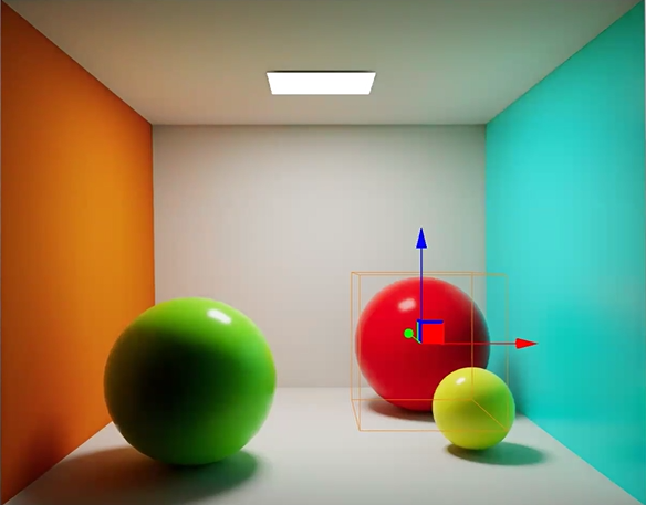

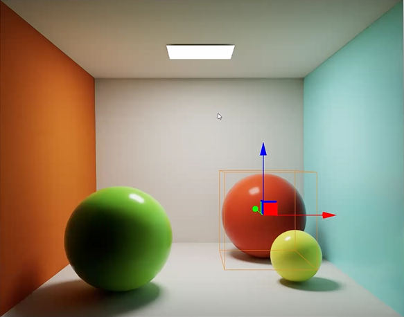

      Linear Rec.709 (sRGB) ACEScg
      2025.1 2025.2
      In the Color Picker, use the L, a, and b values to display colors that are extremely saturated and outside the sRGB color space, as these values below zero. Note that to see them, you will need a display with a wide color gamut.
