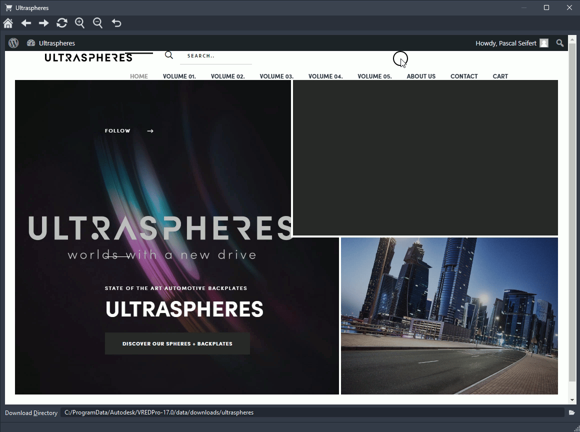

Image of the Ultraspheres Web Shop
Get direct access to Scenebox 360 by Ultraspheres from within VRED. Browse through the content and shop. An HDR and its accompanying backplate are downloaded, once you've enter your user account information, and clicked the Download Now button.
  1. Select Web Shops > Ultraspheres, which takes you to https://www.ultraspheres.at/.
  2. Once you've created an account, select the file you want and download it. The download is a ZIP file, which includes 25K 360° HDR and EXR files and multiple backplates in JPEG format.
  3. Find the downloaded files in your Download Directory location.
