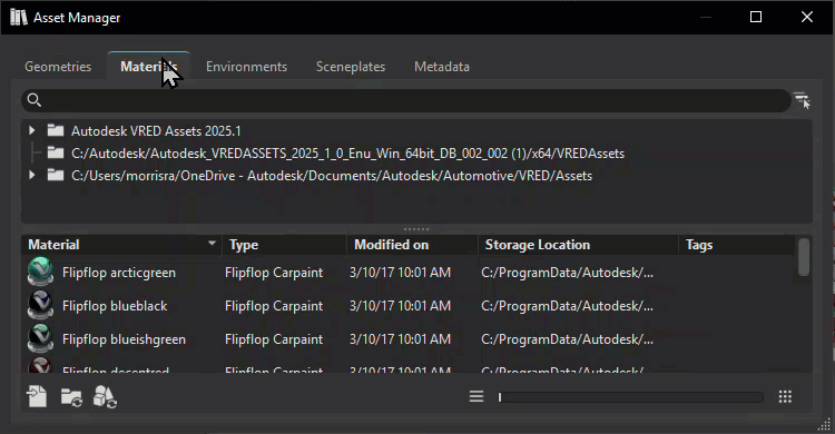

Each tab contains the assets and location of those assets for that category.
Tip:
Use the Asset Manager section in Preferences to set up asset paths either for complete assets or for geometry, materials, environments, sceneplates, and metadata, individually.

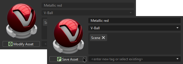

Preferences for these assets are locked after creation. However, for a material or environment asset, pressing the Modify Asset button in the Material Editor unlocks its properties, making them editable. Clicking Save Asset applies the new settings to the reference within the Asset Manager and the icon in the Material Editor changes from Unmodified material asset icon to Modified material asset icon.

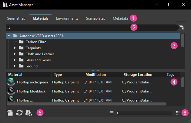

1 Tabs
Along the top of the Asset Manager, there are tabs for easily switching between managing assets for geometry, materials, environments, sceneplates, and metadata. All tabs have the same structure - tab name, file search, library folder tree, list of components, and a zoom slider.
Asset Manager
Metadata sets from the Metadata Editor can be dragged onto any entry in a tab. This changes the tag into an asset metadata tag asset metadata tag. To change an asset's metadata, see Editing Metadata.

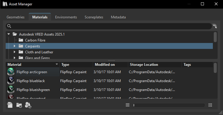

3 Library Directory Tree
All asset paths, as configured in the Preferences, appear here. Select a folder to either import or store an asset from there.

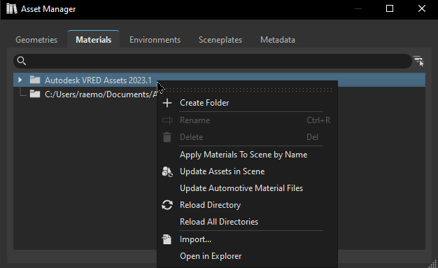

Context Menu
Right-click the folder structure in the upper part of the module to open a context menu. This menu is not the same for every tab.
Context Menu from Library Directory Tree
  • Create Folder icon Create Folder - Adds a new folder or subfolder into the selected library. This is a tab-specific functionality. The new folder is created automatically in the Materials, Scenes, or Environments subfolder of the selected library. If the subfolder does not exist, it is created.
  • Rename icon Rename (Ctrl + R) - Changes the name of the selected subfolder.
  • Delete icon Delete (Del) - Removes the selected folder and all contained files.
  • Apply Material To Scene by Name (folder context menu) - Only available when the Materials tab is selected. Replaces materials in the scene with material assets of the same name from the selected folder in the Asset Manager.
    If there are no matching material names, nothing happens.
    For example, there is a material named Red Plastic in the scene, and a Red Plastic also inside the selected material assets folder. The material Red Plastic in the scene will be replaced by the Red Plastic material from the Asset Manager.
  • Update Assets in Scene icon Update Assets in Scene - Updates all assets (geometry, materials, and environments) contained within the scene.
  • Update Automotive Material Files - Only available when the Materials tab is selected. Reloads the automotive materials, to ensure you are working with the latest versions.
  • Reload Directory icon Reload Directory - Reloads the content or structure of the selected subfolder.
  • Reload All Directories - Reloads content from all Asset Manager paths.
  • Import icon Import - Imports external files into the selected folder. One of the shortcut icons at the bottom of the module makes the same feature quickly accessible.
  • Open in Explorer - Opens the selected folder within Windows Explorer.

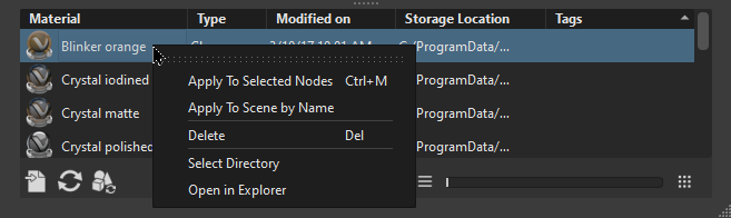

4 List of Components
Contains thumbnails and detail information about the modify date, name, tags, and so on.
Click to select an asset and right-click to open the context menu.
List Context Menu
Right-clicking one of the listed items at the lower part of the Asset Manager module opens a context menu, which is slightly different per tab.
List of Components context menu
  • Add to Scene - Only available when the Environments or Geometries tab is selected. Adds the selected asset as a node, directly below the current scene root. Drag to add it to a custom location within the Scenegraph.
  • Add to Sceneplate Editor - Only available when the Sceneplates tab is selected. Adds the selected asset as an asset backplate or frontplate node in the Sceneplate Editor.
  • Add to Metadata Editor - Only available when the Metadata tab is selected. Adds the selected asset as an asset set node in the Metadata Editor. Find it in the Sets list or enter its name the basic search to find it in other lists.
  • Rename (Ctrl + R) - Enables you to change the name of a subfolder.
    Add to Scene and Rename can only be found in the context menu for Scenes or Environments.
  • Apply to Selected Nodes (Ctrl + M) - Only available when the Materials tab is selected. Uses the selected material on the previously marked nodes in the Scenegraph.
  • Apply to Scene by Name - Only available when the Materials tab is selected. Replaces materials in the scene with the same name with the selected material assets.
    Only the materials tab provides the features Apply to Selected Node and Apply to Scene by Name.
  • Delete (Del) - Removes the selected item directly from library.
    Note:
    Undo is not available for this action.
  • Select Directory - Selects the corresponding folder of the asset's location in the upper folder tree.

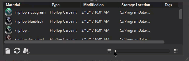

6 Slider
Drag the slider or click its buttons to increase or decrease the size of the asset previews.
Slider in action
