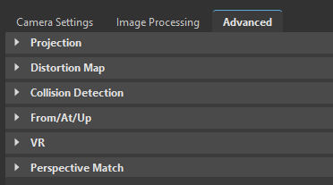

Advanced Tab
Scene > Camera Editor > Advanced
Advanced camera properties, such as projection, distortion map, and collision detection are found in this tab.
Advanced tab of the Camera Editor

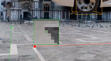

  • Magnify Factor - Sets the magnification factor of the magnifier. The magnifier appears when a vanishing line manipulator handle is selected to help with positioning.
    Magnify Factor at **2**
    Magnify Factor at **16**
    See Position Vanishing Lines Using the Magnifier for instructions on using Magnify Factor.

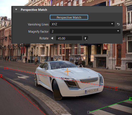

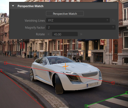

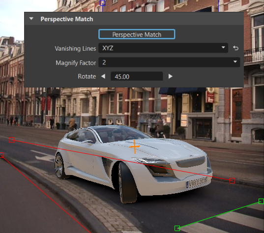

  • Rotate - Rotates around the camera pivot by the number of degrees set, changing the object's orientation against the background. Use the arrow buttons to rotate the camera about the camera pivot clockwise or counter-clockwise.
    Original
    Original pose
    Rotate clockwise
    Rotate clockwise
    Rotate counter-clockwise
