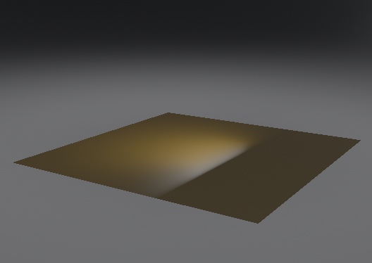

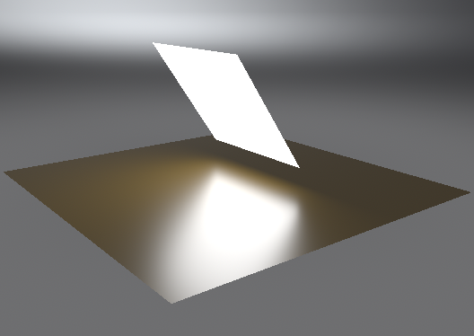

Area lights before VRED 2025 were two-sided, meaning one side was illuminated (A-side), while the other was opaque (B-side).
| 2024 A-side | 2024 B-side |

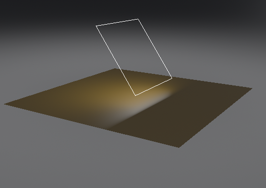

In VRED 2025, we made the non-illuminated side transparent and added a wireframe outline. Now, when a camera is facing this side, the light can be found.
| 2025 A-side | 2025 B-side Wireframe |
Since area lights now have a wireframe visualization, you may choose to hide this. Use Show Light, previously called Display Light, found in the Light Editor > Light Settings > Visualization section, to display or hide the wireframe.
| Show Light Enabled | Show Light Disabled |

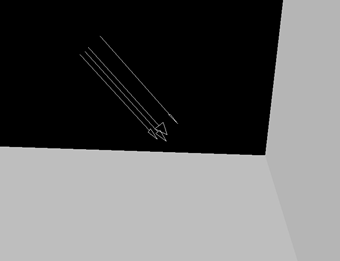

Light rays from directional light sources are parallel like sunlight. A directional light represents a distant light source and has no position, only a direction that affects how the scene is illuminated.

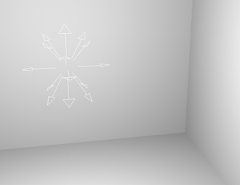

Point light rays start at a single point and emit radially.

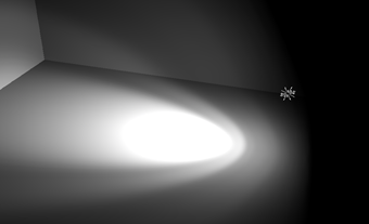

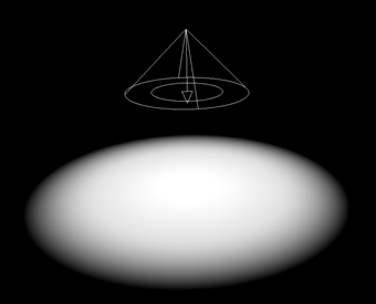

Spot light rays follow a beam cone. They start at a single point and spot in a circular area on the object. It is often used to emphasize an object or surface.

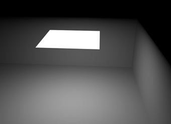

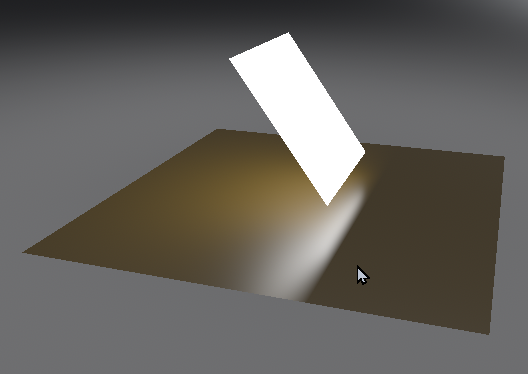

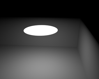

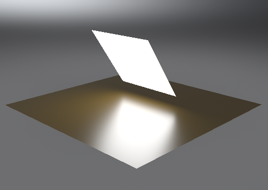

The disk and rectangular lights are area lights that emit light from a flat surface, either from a circle (disk) or square (rectangular).
| Disk Light | Rectangular Light |

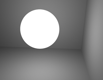

The spherical light is an area light that emits light from a sphere. It is more realistic than point light.
