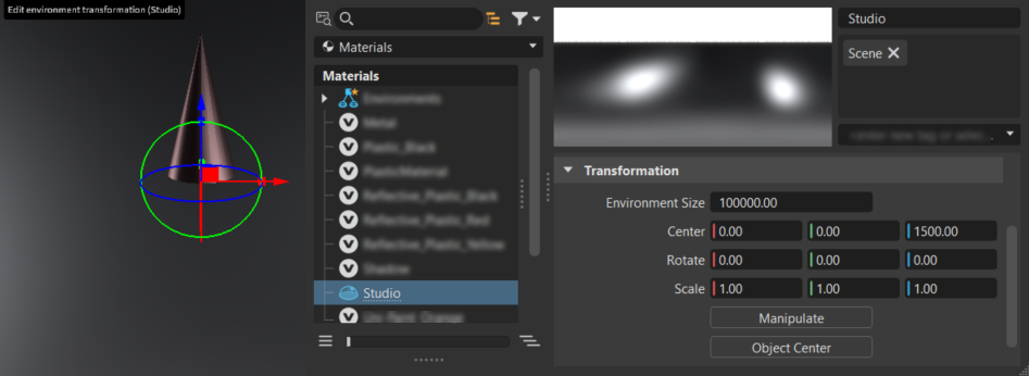

Transformation
Sets the source of spherical projection of the Skylight using the transformation parameters.
Environment Size - Sets the size of the projection. Textures default to infinite projection depth and cover the entire object. You can restrict the texture to one side of the object by limiting the range of the projection. Changing the Z value of the projection size from zero (infinite) to another value achieves the restriction.
Center X, Y, Z - Sets the x, y, and z coordinates for the center of the projection.
Rotate X, Y, Z - Sets the x, y, and z rotation for the projection plane.
Scale X, Y, Z - Sets the x, y, and z scale factor for the projection plane. With the scale value, the image projection can be stretched and squashed on any axis.
Manipulate - Provides texture manipulator in the render window to manipulate the environment in the scene, as you can do with other materials. With an environment selected in the Material Editor, click Manipulate to display a manipulator to rotate, scale, and translate your environment material interactively in the scene. When finished, click Manipulate again to disable it. This function also requires a selection in the Scenegraph.
