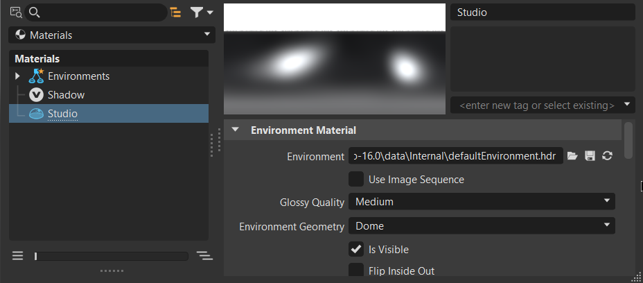

The Sphere Environment gets its representation and lighting behavior from a texture file.
Material Editor Environment Attributes
Environment Material
  • Environment - Loads the HDR image to be used as the lightsource. The HDR image is used as an environment, which is reflected on reflective surfaces in rasterization rendering. In raytraced rendering, the 3D space is reflected in the surfaces. LDR (.png and .jpg) can also be loaded.
    Click Browse icon to locate and assign a texture. When a texture is assigned, the path and filename are displayed in the field to the left.

  • Glossy Quality - Defines the quality for the precomputed glossy IBL. Also, use it for the precomputed raytracing mode. This is not for Full Global Illumination. The entries are internally specifying a sample amount per pixel and correspond to custom or the following values:
    • Low - 256 samples
    • Medium - 512 samples
    • High - 1024 samples
    • Ultra High - 2048 samples
    Higher values generate better the visual quality. Lower values are computed faster.
  • Environment Geometry - Selects the geometrical form for the current environment. Dome, sphere, and cube shapes are available as presets; custom enables you to load an external geometry file.
  • Geometry File - Loads a custom file as the environment geometry.
  • Is Visible - Toggles the primary visibility of the environment. An environment material set to not be visible can still illuminate scene objects, if it is enabled to be used as lightsource, and can still be used for specular reflections in Raytracing.
  • Flip Inside Out - Flips the normals of the environment sphere. This changes whether the environment geometry can be viewed from the inside or outside.
