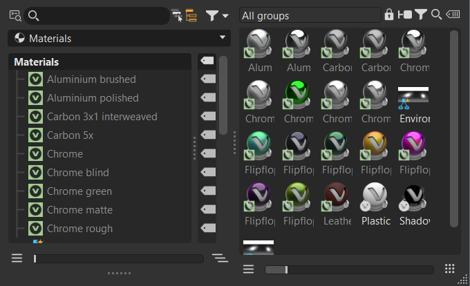

Material Graph/Tags
The Material Graph/Tags shows the logical sorting and listing of the currently created materials or tags. It encompasses the Materials and Tags Selector, Search Bar and Filter, Material Graph, Extension Column, and Tag Lister.
Sets whether a section will display the Material Graph or Tags. Click the selector to pick which view is displayed in which section. By default, one shows the Material Graph and the other, Tags; however, two graphs or tags could be displayed.

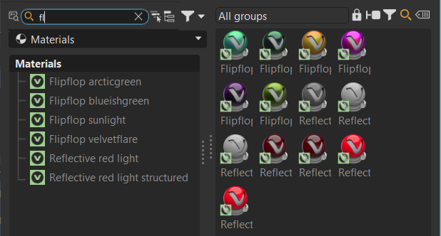

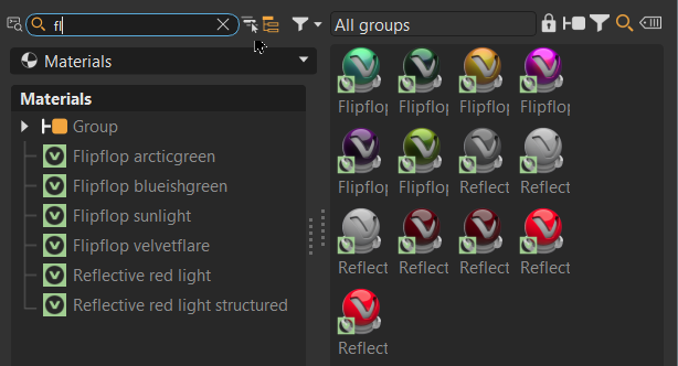

The search field provides live-search capabilities for materials. It is helpful for quickly identifying materials in complex scenes without browsing through a vast list of materials. Search by name. Only single search terms and regular expressions are supported.
Entering one character to show only materials with that character in their name.

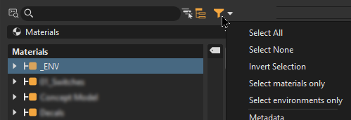

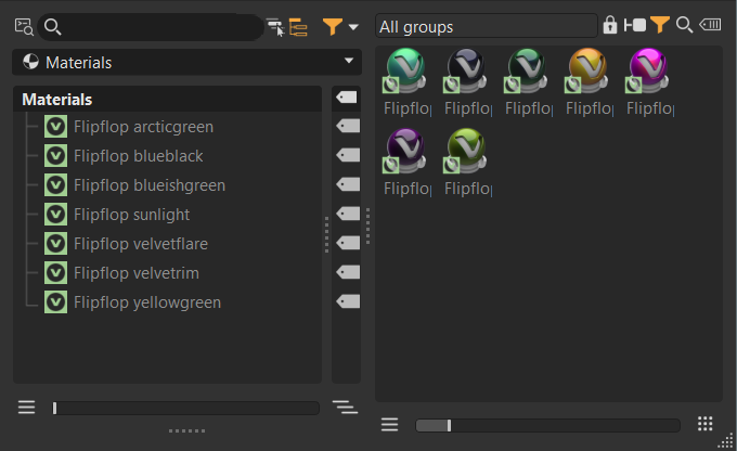

Use Filter icon to open the Filter Selection menu for configuring the filter settings. Press-hold the icon to open the Filter Selection menu for configuring the filter settings. Use it, for example, to toggle between all materials and all Substance materials.
Press-holding the button opens the dropdown menu
Note:
The search and filtering toggles in the Group Preview follows the search and filtering set in the Material Graph and Tag Lister.
The menu contains all the ways you can filter materials, from type to the following. Use these filtering options, in conjunction with a search term and/or tag selection, to further define a search.
  • Select All - Selects all items, which is the default.
    Select None
  • Select None - Clears the filtering selection, reloading all the materials in the Group Preview. Filtering is automatically deactivating in both the Material Graph and Group Preview.
    Filtered After Select None
    Filtered material list Select None
  • Invert Selection - Deselected all previously selected items, and selects all items previously unselected.
  • Select Materials Only - Selects all materials, while deselecting everything else.
  • Select Environments Only - Selects all environments, while deselecting everything else.

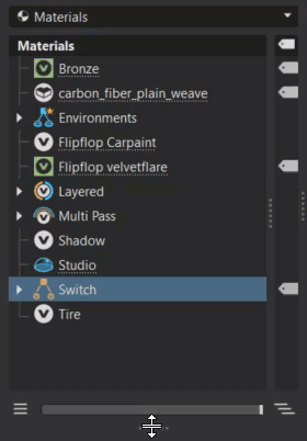

Lists all the materials, environments, switches, and groupings within the scene.
Material Graph

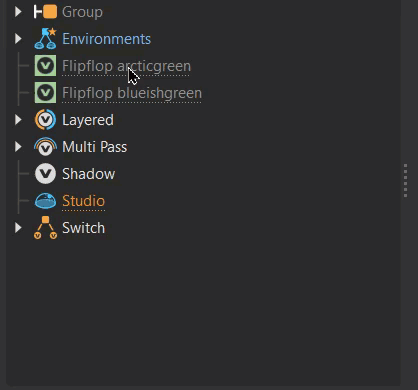

These are the icons you will see in the Material Graph and what they represent.
  • Assets dropped from the Asset Manager into the Material Editor are represented by Asset icon.
  • When an asset has been modified, its icon will include little pencil.
  • If an asset had been deleted from where it was stored, red triangle with an exclamation mark appears at the top of the icon.
Icon Element
OCS material icon OCS
Substance material icon Substance
Substance Panorama material icon Substance Panorama
GLSL Shader icon GLSL Shader
X-Rite material icon X-Rite
MaterialX icon MaterialX
MDL Material icon MDL Material
Asset icon Asset
Layered material icon Layered
Multi Pass material icon Multi Pass
VRED material icon VRED Material
Environment Environment
Switch icon Switch
Environment Switch icon Environment Switch
Group Group

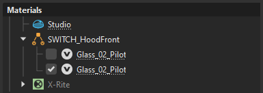

When a material or environment is underlined, this means it is used elsewhere, such as within a hierarchy, like a switch.
Underlined element
When Select all Occurances is used, the text of parent node containing the selected material is highlighed blue, indicating a copy of the selected underlined material can be found within.
blue highlight

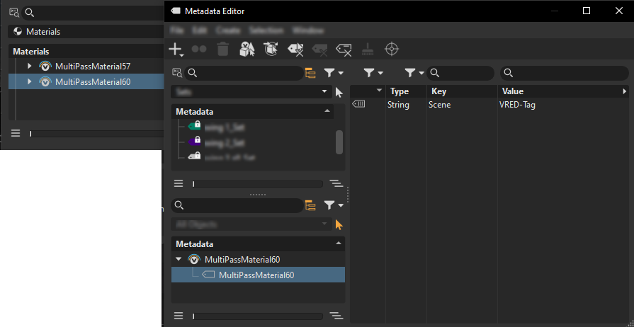

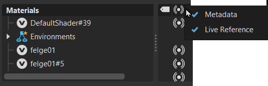

The Expansion Column displays icons showing which nodes contain metadata and which are from a Live Reference. The column is tucked into the Material Graph.
  • To expose the column, if not displayed, pull the grip.
  • To load a node with metadata into the lower list of the Material Editor, double-click a metadata icon.
    Metadata Editor with the node loaded into the lower list
  • To open the Live Reference Module and see the node highlighted, double-click the Live Reference icon.
  • To show or hide a column, click triangle icon, then click an option to either add a check to display it or remove a check to hide it.

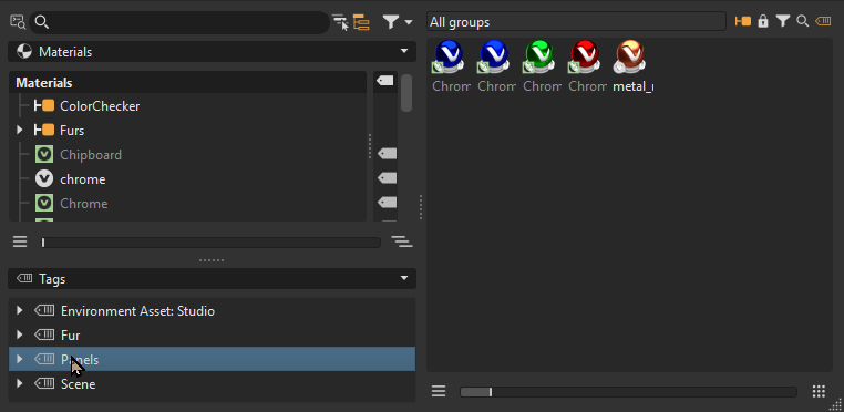

Clicking a tag filters the Group Preview, displaying only the materials within the selected tag.
tag is selected

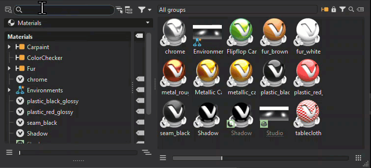

Clicking an empty space in the Tag Lister, resets Group Preview, displaying all materials.
Select None

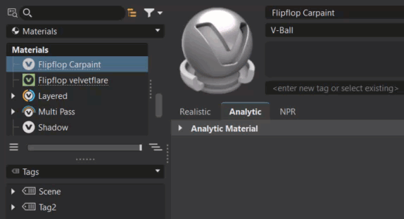

Click-dragging one or more materials onto a tag adds them to that tag.
Adding materials to a tag

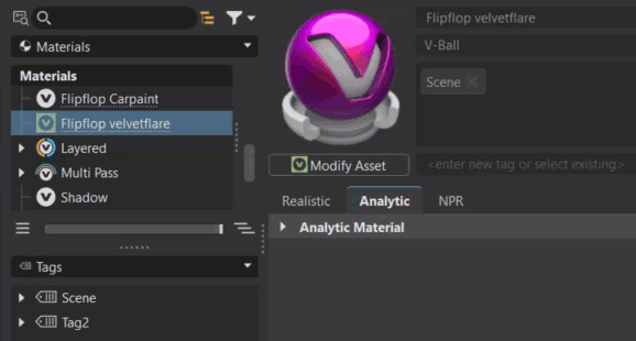

Doing either of these adds a tag to a material:
  • RMB-dragging a tag onto a material in the Material Graph.
    Drag a tag onto a material
  • RMB-dragging a tag from the Tag Lister and dropping it into the Attributes Tags field.
    RMB-drag a tag into the Tags field
