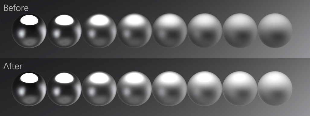

Use Clamping
Activates clamping of bright pixels to eliminate white spots after antialiasing. The value sets the maximum value for a white pixel.
As of 2026, the upper limit, which can be set in the field to the right, was removed, as it was too low for some scenes. Now, scenes with very bright lights using physical camera settings for LEDs no longer have grey areas that should be bright.
Important:
Activating clamping and reducing the value reduces the maximum resulting image color range.

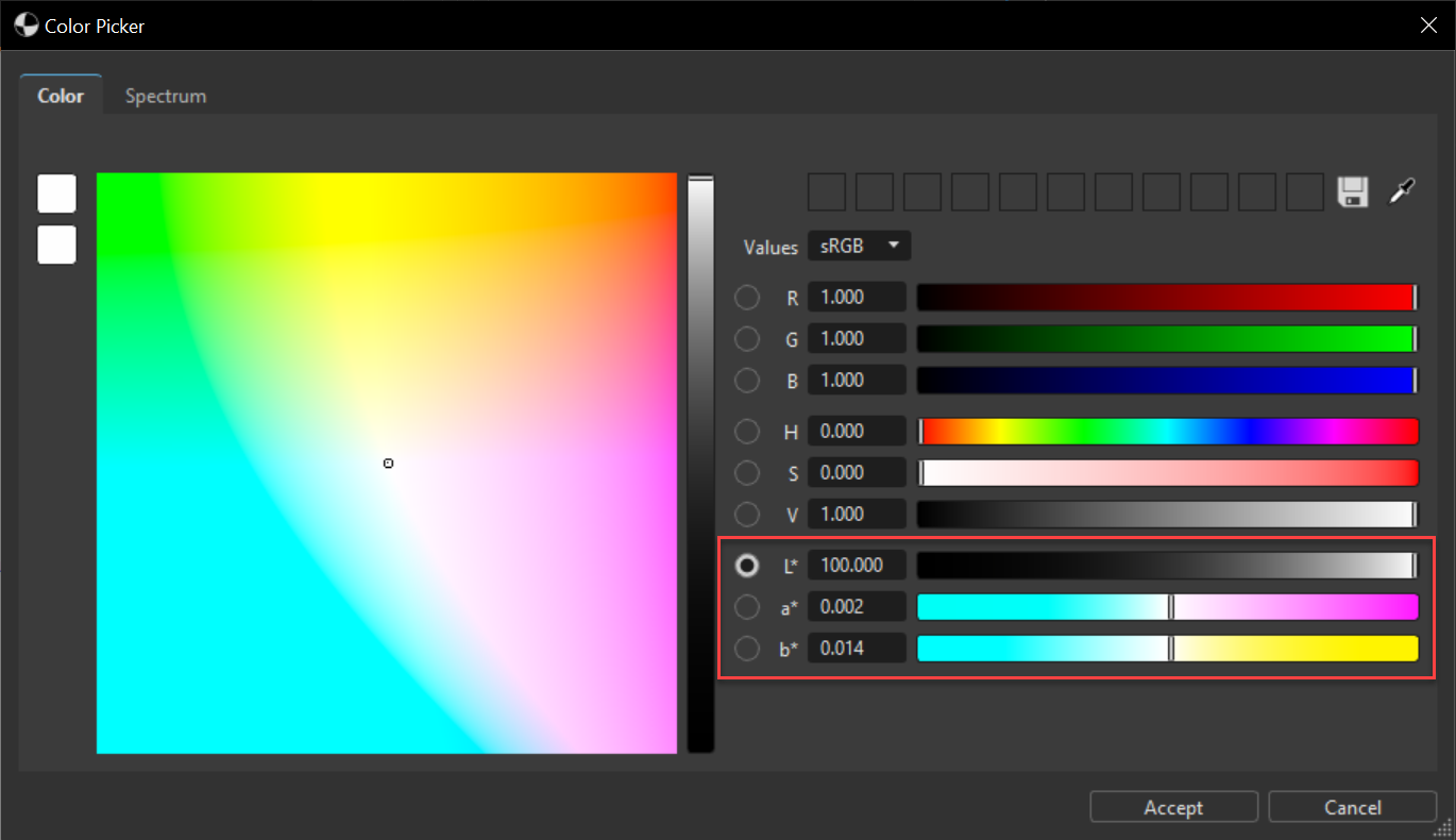

Within the Color Picker of the Material Editor, use the L, a, and b values to edit these colors. These are extremely saturated and outside the sRGB color space. Note that to see them, you will need a display with a wide color gamut.
New L, a, and b color space values
