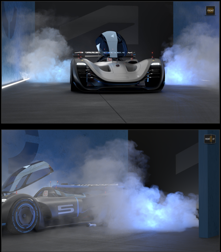

Volume Quality
To achieve a balance between quality and performance, it is possible to customize the quality for each volume material. This allows for fine-tuning and finding the optimal tradeoff between the two factors.

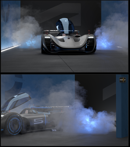

Choose the method used when rendering a volume.
| Ray-marching | Multi-scattering |
However, it is more computationally intensive and requires more samples to converge to achieve a noise-free result. Therefore, it is currently only available for Raytracing.
Sets the global volume maximum quality by determining the distance to traverse each volume. This setting acts as a limit for the combined visual quality of all volumes along each view ray. In most cases, a value between 1 and 100 is sufficient. If the total number required to traverse volumes exceeds the maximum quality, things are adjusted accordingly. Increasing this value improves the quality, but also decreases performance and even can cause a driver crash.
Sets the interactive amount of volumes that each ray may encounter.
Sets the still frame amount of volumes that each ray may encounter.
