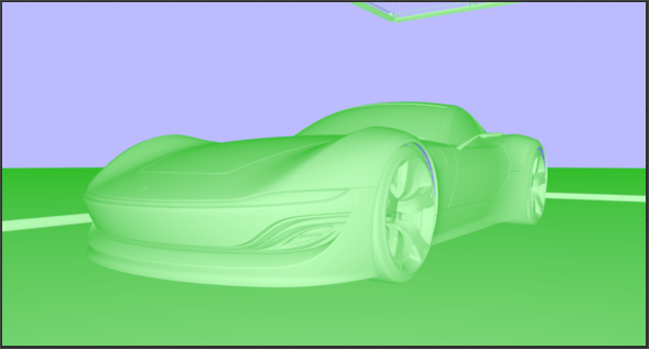

Vertex/Face Normal Rendering
Gives visual feedback about the orientation of vertex and face normals, helping you see if a surface is oriented incorrectly. It makes it easier to align inconsistent normal orientations. See Working with Normals for how to use this.
Normals
Four colors are used to indicate different normal orientation:
  • Green - Face and vertex normals are consistent and point towards the camera.
  • Blue - Face and vertex normals are consistent and point away from the camera.
  • Gold - Face and vertex normals are inconsistent. Face normals point away from the camera; vertex normals point towards the camera.
  • Magenta - Face and vertex normals are inconsistent. Face normals point towards the camera; vertex normals point away from the camera.
  • Red - As of 2023.2, face and vertex normals are NaN or have a zero length, which creates NaNs when normalized.
  • Pink - As of 2023.2, face and vertex normals have an absolute angle between the face and vertex normal above a threshold, such as 85°.
The best way to turn face or vertex normal orientation when the whole shape is affected is to use the Geometry Editor (Scene > Geometry Editor). Inconsistent normals within one shape require pressing the Alt key in combination with the right-mouse button on the affected area. This aligns the orientation of face/vertex normals with the orientation of the faces and vertices around it. If all normals are consistent, upon operation, it enables you to turn them completely.

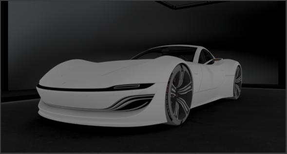

Ambient Occlusion Rendering
Creates a grayscale rendering, in which the pre-calculated ambient occlusion data is shown exclusively. This is useful when evaluating precomputed shadows. It displays any subtle variations in lighting and helps you see surface details that would be difficult to discern, so it's great for finding flaws in a surface. If the lighting in our scene is too bright, it can be used to soften it. Toggle this on to see the precalculated ambient occlusion of the scene.
Ambient Occlusion example

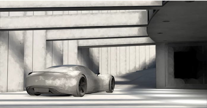

Precomputed Illumination Rendering
Shows any baked illumination, whether indirect, direct (like when baking with the Light and Shadows mode), or the sum of both direct and indirect illumination for Raytracing as well as for Rasterization.
Important:
This is only available for Rasterization rendering and for Raytracing with Precomputed Illumination modes using baked illumination. You cannot view baked illumination while in Full Global Illumination raytracing. But, like with the old Indirect Illumination Rendering mode, you can view a photon map or final gather map (if enabled).

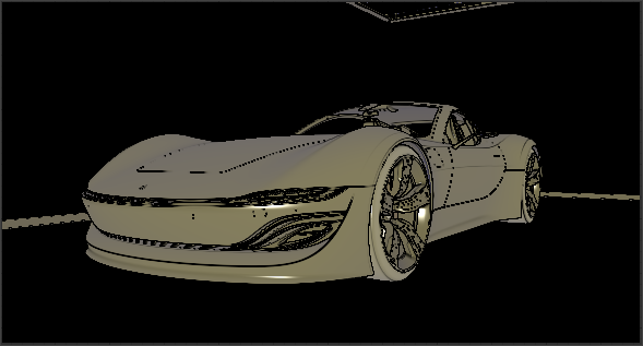

Surface Analysis Rendering
Analyzes the quality of a surface. Options of this rendering mode are defined in the Surface Analysis module. Examine the continuity of various types of virtual lines projected onto the object's surfaces. This makes it easy to detect discontinuities. This also supports polygonal, as well as NURBS data.
The Surface Analysis window opens automatically when activated. See Analyzing Surfaces for activating and adjusting settings.
Surface Analysis Rendering example

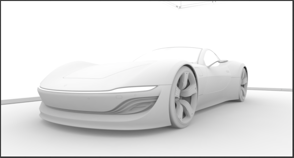

Analytic Rendering
Uses a basic shading quality, without distracting reflections. It only uses standard light sources and ignores IBL (image-based lighting).
Analytic Rendering example

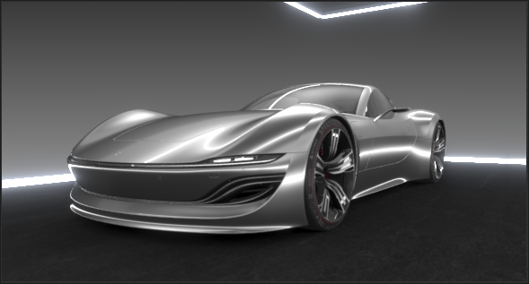

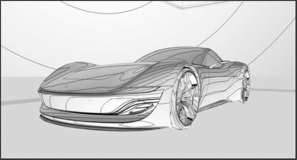

Non Photorealistic Rendering
Non photorealistic rendering is an OpenGL render mode, for rendering schematic images. Use NPR shading for outline rendering.
Non Photorealistic Rendering example

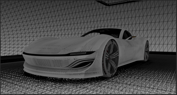

Wireframe Rendering
Shows the polygonal mesh of the selected objects highlighted in orange color. The mesh is shown in addition to the shaded illustration. Other objects can hide it until Edit > Preferences > General Settings > Selection > Wireframe > Always in Front is disabled.
This changes how the scene is rendered in the Viewport. When enabled, everything is rendered in wireframe, reducing calculation time and resource needs. The wireframe color can be set in Edit > Preferences > Rendering > Render Window > Wireframe.
wireframe rendering
When disabled, everything is rendered as expected.
wireframe rendering disabled

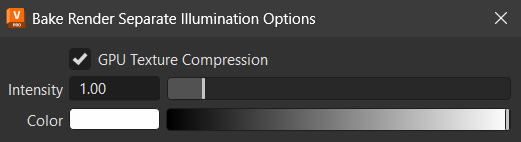

    Bake Render Separate Illumination Options
    Bake Render Separate Illumination Options dialog
    • GPU Texture Compression - Enables GPU texture compression for lightmaps to reduce memory consumption on the GPU. If any compression artifacts become visible when 3D rendering, disable this option. Currently, only separate lightmaps are compressed.
      Note:
      Activating the compression can take a while, depending on the number of separate lightmaps and their size, as textures are compressed and uploaded to the GPU.
      Artifacts might be more visible when viewing the raw texture data with Visualization > Precomputed Illumination Rendering, but less visible in Realistic Rendering, depending on how the lightmap data is combined with other real-time light (e.g., from the environment).
    Tip:
    For Python users, try this script: setLightmapGPUTextureCompression(on)
    • Intensity - Controls for changing the intensity of all separate lightmaps. Use it to turn lights on and off or dim and brighten them. You can use scripts to create Variant Sets.
    • Color - Controls for changing the color of all separate lightmaps. Use it to multiply the light with a color and change it. You can use scripts to create Variant Sets.
