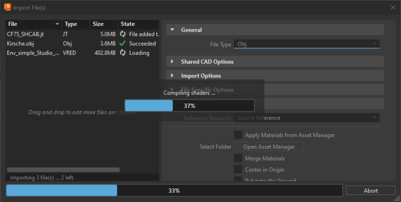

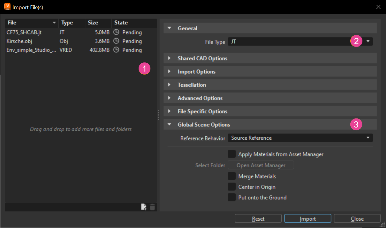

The Import File(s) Dialog
Import File(s) consists of two areas, the Import File List on the left and the File Type Parameters on the right. Drag and drop files into the Import File List or add them using the Add button. Select a file from the list, then click File Type and select the file type associated with your selection. This loads import parameters for that specific file type.
Import File(s)
1 Import File List
Once the Import File(s) dialog opens, the files for import appear on the left. Drag and drop more files and folders into the list. Check the State column to see if files have been imported, are pending or loading, have been successfully imported, aborted, or failed.
Import File(s) with Aborted

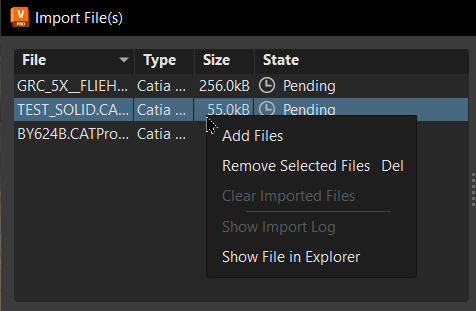

Use the right-click menu to add or remove files from the imported file list. Use other right-click options to show a file location in an Explorer window or view the import logs.
Right-click menu
How the Import File(s) Dialog Works
Enable and set the parameters you want. The type of file selected, determines the parameters that appear to the right.
For example, when a Catia file is selected and the File Type is set to Catia V5, in the Shared CAD Options section, you can use the Mode option to batch convert CAD to OSB without loading files into VRED and ATF to import native Rhino .3dm files. Features like surfaces, meshes, curves, etc. are supported.
Once you click Import, you can check the state of files during import using the State column. Messages like pending, importing, converted, merged, and stitched appear to indicate the current ATF (Autodesk Translation Framework) conversion state. Since logfiles tracks several ATF tasks, during import, these need more time.
Note:
If the Temporary Path preference option has been set, which changes the import temporary path of a file, the change is applied to the Import File(s) dialog the next time it is opened. However, if the Import File(s) dialog is open during the change, the path will NOT update immediately. For more information, see Temporary Path.
Keep in mind, when importing an ATF file, if the Import/Export > File Options > Options tab > Base > Temporary Path preference contains an incorrect path, the import will fail. However, when importing only non-ATF files, the path will not be validated; therefore, even if the path is invalid, the import will succeed, and no warnings will be written to the terminal.

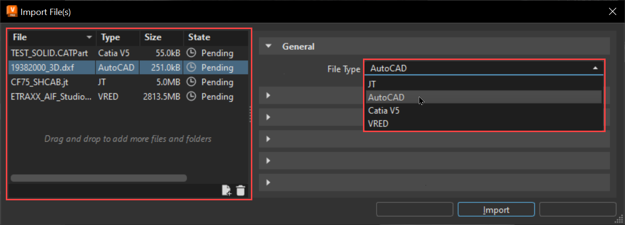

2 Import File Parameters
General
When a file in the Import File List is selected, parameters appear to the right. Use the File Type dropdown menu to load parameters for that specific file type.
Import File List
  • File Type - Provides options for loading the correct import parameters specific to the selected file type from the list to the left.

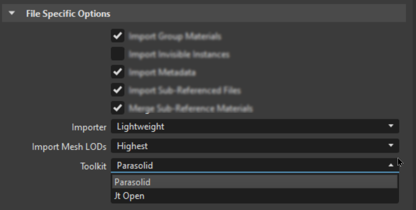

File Specific Options
  • Import Group Materials - Doesn't create additional MaterialGroup nodes for part files, assemblies, or instances, and simple discards the materials, when disabled. For some Inventor workflows, you may want this enabled to create these MaterialGroup nodes.
  • Import Associative Meshes - Imports data associated with your meshes, rather than excluding it.
  • Import Invisible Instances - Toggles the import of invisible instances on or off. When enabled, invisible (hidden) instances are imported into VRED, rather than excluded.
  • Import Coordinate Systems - Toggles the import of the Axis Systems from CATIA into VRED. Since CATIA files can have multiple coordinate systems, VRED see these, import them, and create transformation groups with a coordinate cross for a better representation in the viewport.
    Note:
    There is also an Import Coordinate Systems preference in the FileIO > Catia V5 > File Specific Options preferences.
  • Import Cameras - Imports cameras from the Alias .wire file, instead of excluding it.
  • Import Lights - Imports lights from the Alias .wire file, instead of excluding it.
  • Import Variants - Imports variants from the Alias .wire file, instead of excluding it.
  • Import Template Geometries - Imports template geometries from the Alias .wire file, instead of excluding it.
  • Import Switch Materials - Imports an Alias switch shader as switch material from the Alias .wire file, when enabled. However, when disabled, only the active shader in the Alias switch shader is imported, eliminating the import of any unwanted shaders.
  • Import Metadata - Imports the metadata from the file, instead of excluding it.
  • Import Animation - Imports animation from the Alias .wire file, instead of excluding it.
  • Reduce Constant Keyframes - Reduces the number of keyframes from the Alias .wire file by removing adjacent keyframes with identical values.
  • Import Sub-Referenced Files - Imports all part files, sub-assemblies, and sub-references contained within an imported file.
    When disabled, only the structural information (tree) appears in the Scenegraph, not geometry. All sub-assemblies are imported, with their part files in an unloaded state.
    When enabled, all sub-referenced files are imported in their loaded state.
  • Merge Sub-Reference Materials - Controls how duplicate materials are handled when importing CAD assemblies and PLMXML files. They are either merged or instances of the duplicates are created.
    When disabled, duplicate materials will NOT be merged. If an identical material is referenced by sub-referenced files, an additional instance of the material is created for every occurrence of the material in the import.
    Merge Sub-Reference Materials disabled
    When enabled, duplicated materials are merged, referenced by sub-referenced files. This option is enabled by default.
  • Model State - Sets the Inventor model state used when importing an Inventor file into VRED. This is an either/or option, so the ATF API doesn’t allow the import of multiple, both, or a specific model state, at this point.
    Choose either the Primary or Last Active Inventor model state for the Model State option in the Import Files > File Specific Options section.
    To set a default Inventor model state, see the Edit > Preferences > Import/Export > File Type > Inventor > File Specific Options section, choose a state for the Model State option.
  • Import as Smart Reference - Imports a native VRED file as a smart reference.
  • Reference Behavior - Choose a reference behavior when importing. Either keep or remove references.
  • Importer - Choose one of the following methods for importing Catia V5 files. There should be no differences in tessellation quality, structure, material import, or naming conventions between these methods.
    • Lightweight - The faster default method for importing V5 files, which skips several operations in ATF that are not required to translate CAD data to VRED.
    • Legacy - The old method for importing V5 files, which is a fallback if issues arise using the Lightweight method.
  • Import Mesh LODs - Imports Static Mesh Levels of Detail (LOD) into VRED from 3D modeling applications, such as 3ds Max or Maya. Choose from Lowest, Highest, and All. All imports all currently selected FBX files with specified VRED settings.
  • Toolkit - When Legacy Import is activated, this option is disabled.
    Toolkit
    Sets the toolkit used by VRED. Choose one of the following options:
    • Parasolid - Uses the current behavior.
    • JT Open (Experimental) - Uses the new behavior for importing JT files.
  • Max Parallel Import Tasks - This feature is only for Autodesk Alias WIRE files. Sets the maximum number of import tasks. Changing this value increases memory usage.
  • Import Layer Folders - This feature is only for Autodesk Alias WIRE files. Imports any Alias layer folder from an older version of VRED, converting it into a VRED group and layers within the folder into a subgroup as they are imported into VRED 2021.3. This changes the scene hierarchy. To keep the scene hierarchy unchanged, toggle this option off.
    To set a default behavior when importing Alias files, go to Edit > Preferences > Import/Export > File Type > Alias > Import > File Specific Options, and either check or uncheck Import Layer Folders.
  • Import Empty Layers - Toggles the import of empty layers on or off. When enabled, empty layers are imported into VRED.
3 File Type Parameters

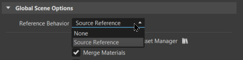

Global Scene Options
  • Reference Behavior - Determines what happens to references upon import. Choose one of the following:
    • Source Reference - Imports the references as source references.
    • None - Combines all references into the project and removes the file/reference information.
      Reference Behavior
  • Apply Materials from Asset Manager - Replaces imported materials with similar materials from the Asset Manager. Click the icon to the right to access the Asset Manager.
  • Merge Materials - Merges materials when importing a CAD file.
  • Center in Origin - Places imported geometry in the center of the VRED environment.
  • Put onto the Ground - Places imported geometry on the ground plane.
  • Import Animations - Only available for OSB and VPB files. Imports animations contained within the file.

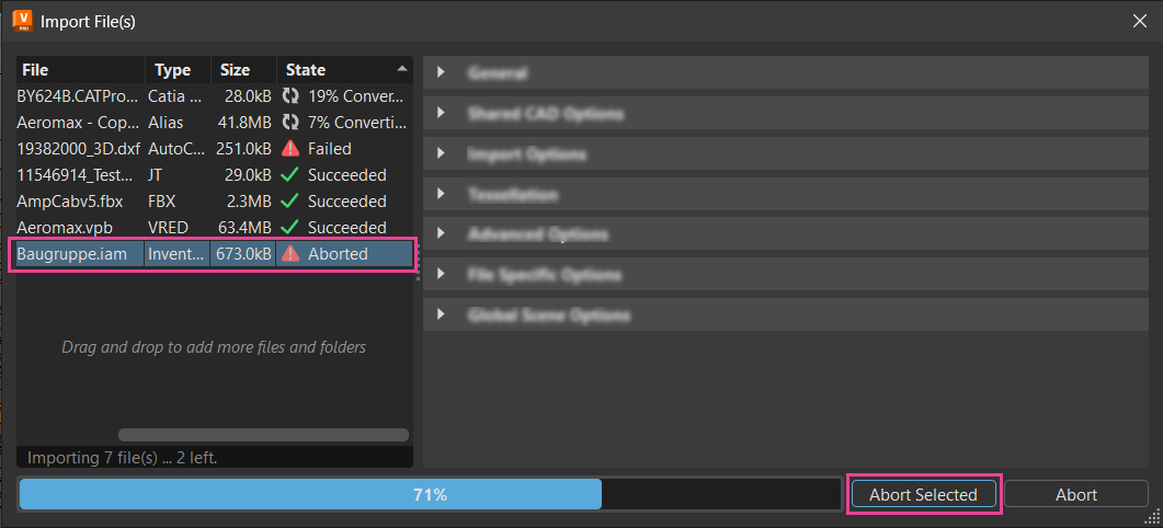

4 icon Import Buttons
Find these buttons at the bottom of the dialog, along with an import status bar to monitor progress.
  • Reset - Resets the options to the right to their default state.
  • Import - Imports all files in the file list into your file.
  • Abort Selected - Aborts the import of the selected files.
    In the file list, click one or more files to highlight and select them, then click Abort Selected. Red Warning Triangle icon Aborted will appear next to the selected files. Use this to save time by not loading these files.
  • Abort - Stops the import process. No files are imported and the dialog is closed.
