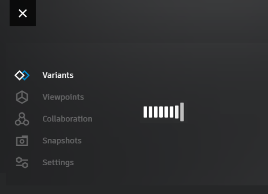

Video captions: In VRED 2022.2, we added several new features which help you in your visualization process to get more efficient. We improved our streaming app and added a scrollbar to the UI. This indicates off screen options and helps to get a better orientation. Additionally, you can now join or create a collaboration session. So, you can use your mobile device, for example, and join a session from there. You will see all avatars of your team within the scene now, and they can see you, as well.

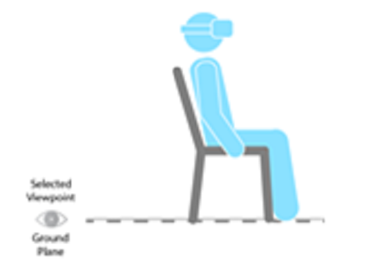

For VR, we added a new camera option which lets you use the camera height as the VR Ground Plane. With this option, you can mimic different persona heights. Just create a viewpoint with the desired height and enable the option here. Just enable the option in the Camera Editor, set your desired height, and create a viewpoint. Now you can access this viewpoint in VR, which brings you instantly into another persona's height, and you can explore the scene from there. For example, when setting the camera height to -200, I will be 200mm shorter in VR then.

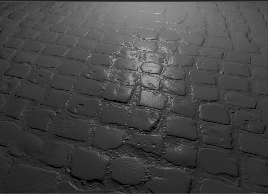

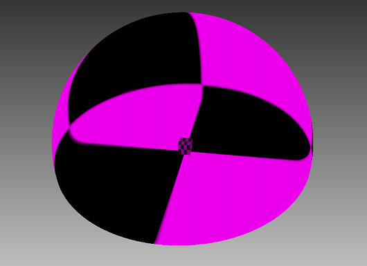

When talking about textures, we also added a new option in the normal map area. You can now flip the normal's texture in U and V direction, separately. Now, you don’t need to go back to an image editing software in order to fix wrong normal textures. Also, for textures and for saving the video cards memory, you can now enable OpenGl texture compression and clear GPU memory. This will be very helpful for users who don’t have much video memory.
