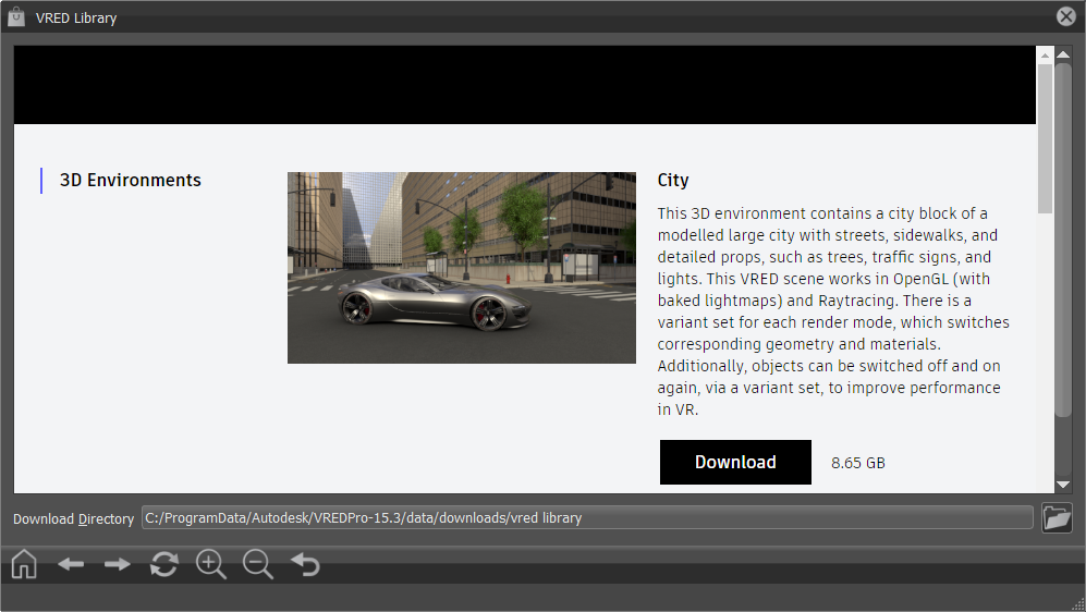

This 3D environment contains a city block of a modelled large city with streets, sidewalks, and detailed props, such as trees, traffic signs, and lights. This VRED scene works in OpenGL (with baked lightmaps) and raytracing. There is a variant set for each render mode, which switches corresponding geometry and materials. Additionally, objects can be switched off and on again, via a variant set, to improve performance in VR.

In the VRED Library, scroll to see each 3D environment.
Click Download to download the VPB file to either the default location, C:/ProgramData/Autodesk/VREDPro-15.3/data/downloads/vred library, or a specified location, using
When you click
, the asset files are not displayed, as this is only for setting a directory. To see the asset files, open an Explorer window and enter C:\ProgramData\Autodesk\VREDPro-15.3\data\downloads\vred library.
Below the toolbar, an indicator animates as the file is downloaded and it disappears when complete. Some of these files are very large, so this process can take some time.

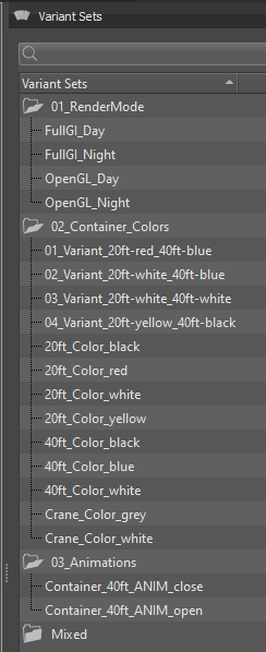

The Industrial Harbor 3D environment comes with day and night scenarios. The 3D environments also have additional objects, lights, cameras, and materials. Use the Variant Sets module to toggle these on or off.

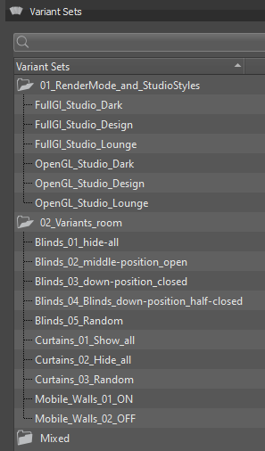

In the Modular Studio, you can choose one of three room configurations: Dark, Design, or Studio. Each configuration has its own lighting scenario and uses different objects and room elements. In addition, details, such as curtains, blinds, and presentation walls, can be modified.

In the Variant Sets module, double-click 01_RenderMode to expand it, then double-click one of the following: OpenGL_Day, OpenGL_Night, FullGI_Day, or FullGI_Night.
The Industial Harbor environnment serves as an example here. In other 3D environments, the names of the variant sets may differ.
Each 3D environment comes with its own unique additional configuration options. In the Variant Sets module, double-click the various sets and explore the assets to change up our scene. For example, for Industrial Harbor, use one of the variant sets in the group 02_Container_Colors to change container colors. For Modular Studio, use one of the variant sets in the group 02_Variants_room to change the position of the blinds or to show and hide curtains and mobile walls. If you want to restore the original room configuration, select one of the studio styles (Dark, Design, or Lounge).
Using the Modular Studio 3D environment, with ShadowPlane_Vehicle_On selected, in the Quick Access Bar, click
In the Variant Sets module, double-click 02_Variants_room to expand it, then double-click any of the variants listed to change the 3D environment assets.
To set keys for the different variants, in the General tab, select each variant, then use the Hotkey fields to assign a unique shortcut for each one. Now, you can use these hotkeys to switch the environment during a presentation.
