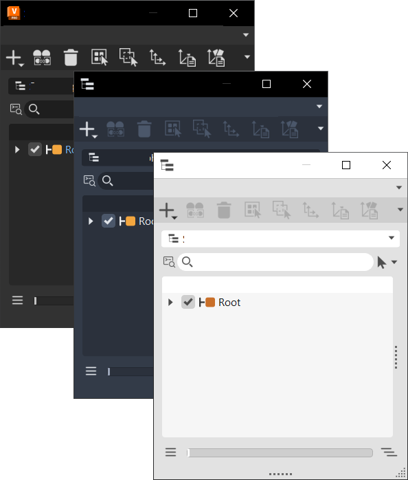

You can now change the color theme used in VRED. Choose from dark grey, dark blue, and light.
In the Window menu, select Color Themes and choose a theme color. Since VRED uses colors throughout the UI to help to indicate states or to differentiate one field from another, these will vary slightly from one theme to the next.

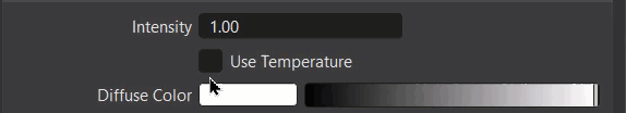

In modules, button, checkbox, and field coloring indicates changes to indicate its state.
When active, these are framed or underlined pale blue.
When hovered, these are framed or underlined pale blue.

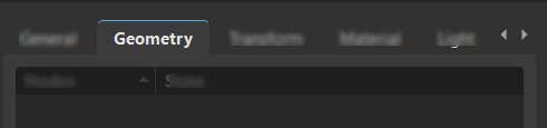

When a tab is selected, a blue line appears above it, indicating it's active.

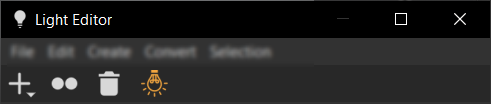

Toolbar icon coloring indicates changes to indicate its state.

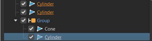

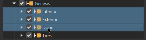

The coloring in the various tree views can indicate the state, hierarchy, or even whether something is a clone.
When tree items are selected, these are highlighted blue.
When tree items are cloned, the selected clone is underlined and white and others are underlined and orange.

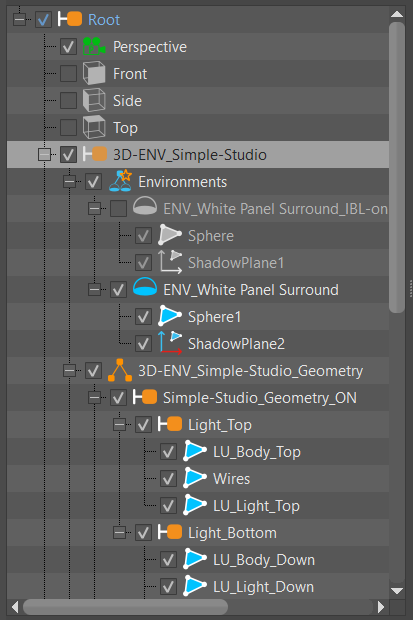

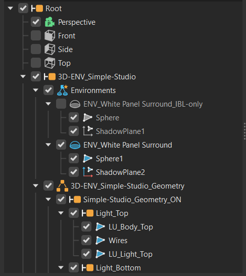

In the Scenegraph, you will notice the tree has been refreshed, making it easier to read and displaying more content in less space to reduce scrolling.
| 2023 | 2024 |
