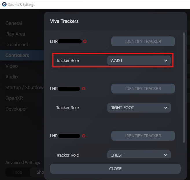

Video captions: In VRED 2024.1, we added more features for OpenXR. We have added a Vive tracker extension, so you can add the Vive trackers. Now, we can also add the Vive trackers in OpenXR like you are used to in OpenVR. However, please be aware that OpenXR requires every tracker to have a different role assigned, which you do directly in the SteamVR settings.
The OpenXR tracker looks like this and OpenXR requires that every tracker has a different role assigned. Use it to track movement and bring objects from the real work into VR.
Use the StreamVR Settings to do this and select Controllers > Manage Trackers.
In VR, once roles are assigned, when trackers are on, they will appear in your view and the StreamVR display.
Tracker Off | Tracker On |
Since Handheld Object are currently not supported, custom controllers can be used to define them. If the same role is assigned to multiple trackers, the OpenXR runtime will choose one and this will be the only one available in VRED.
