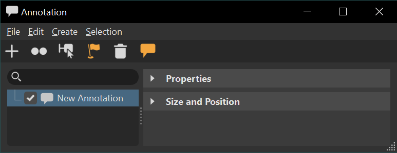

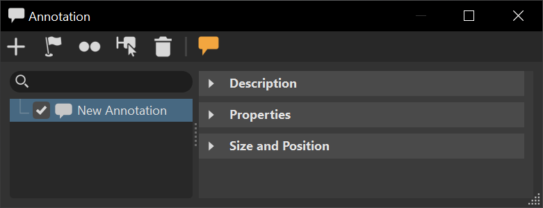

We added a menu bar, rearranged the QuickActions Bar icons, moved the Description option into Properties, and updated the layout within the Attributes. See Annotation for more information.

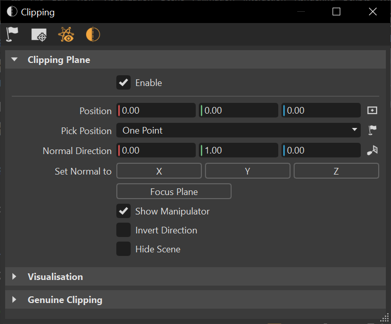

We adjusted the layout of the Clipping module and added to the QuickAccess Bar.

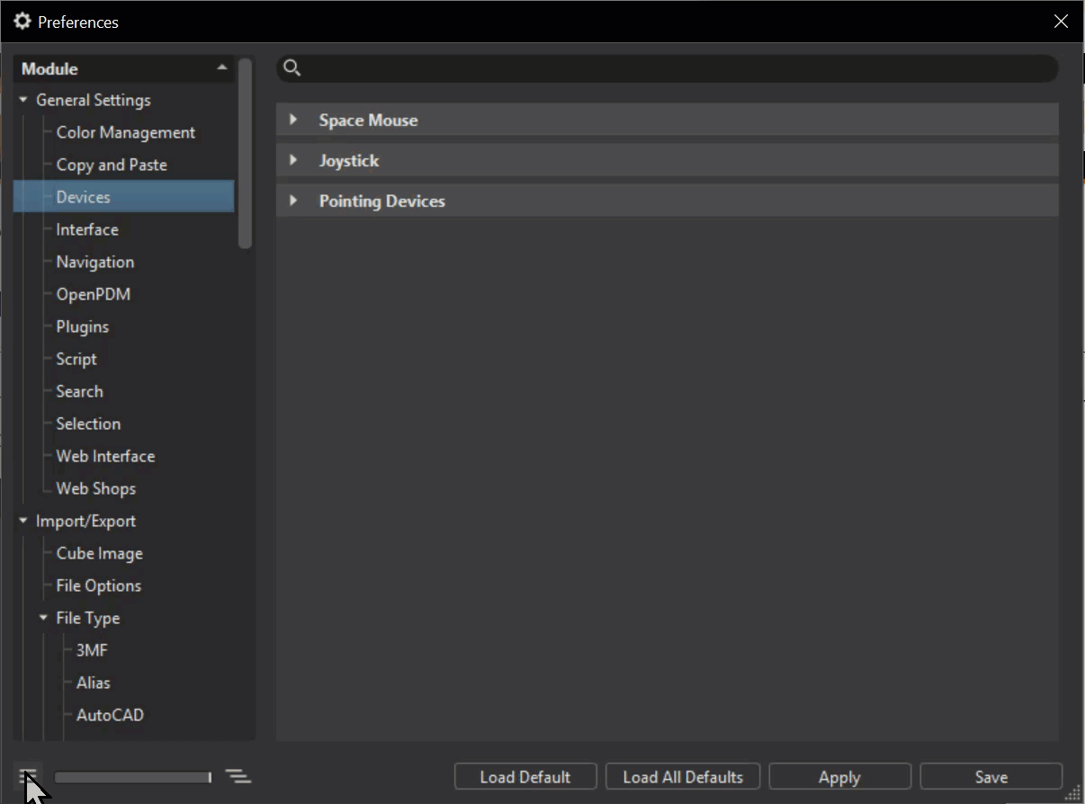

Added a slider to the list tree for expanding or collapsing it in the preferences.

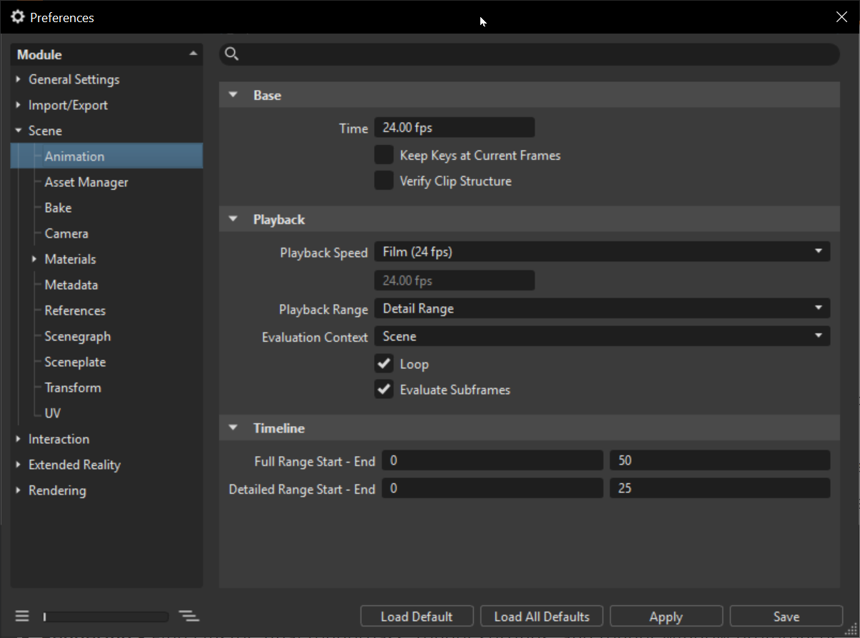

Updated the layout and alignment of the Animation preferences.

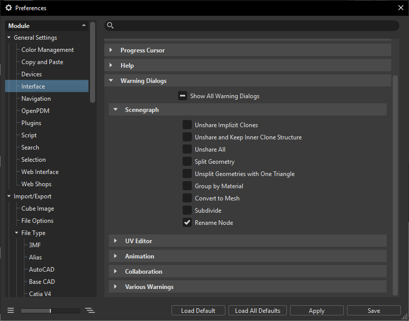

Added the Show All Warning Dialogs option to Edit > Preferences > General Settings > Interface > Warning Dialogs to re-enable the display of confirmation dialogs that have been hidden.

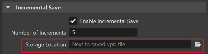

Added the option, Storage Location, for specifying the location of incremental file saves. All increments will be saved inside the selected absolute folder at Edit > Preferences > File Type > OSB / VPB Preferences > Export Tab > Incremental Save > Storage Location. Click
to browse and set a new storage location.
Keep in mind, if a path is unspecified, invalid, or inaccessible, the directory returns to the default. In that case, a new folder is created inside the project directory of your current open .vdb file, where all increments will be saved. Defining a custom folder within this relative path is possible by typing its relative location and the name of the folder (newLocation/mybackup).

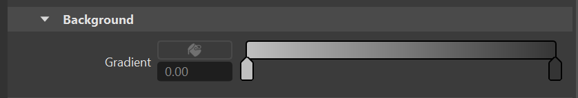

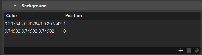

Replaced the background color list with a ramp slider in the Edit > Preferences > Rendering > Render Window > Visualization tab > Viewport > Background section.

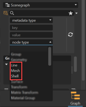

We've added Shell, Mesh, and Line to the Scenegraph Advanced Search node type list.
