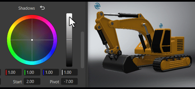

Under Primary, you will find 3 new color wheels for Exposure, Contrast, and Offset. You can also use the vertical sliders to adjust the values. And, if you want to reset your values, just use the reset button.
The Tone menu is very similar with 5 different colors wheels for Blacks, Shadows, Midtones, Highlights, and Whites.

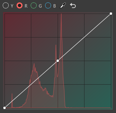

The RGB Curves frame allows adjusting the tones using a B-Spline curves, where you have a curve for R, G, B, and one master curve. Use either the existing 3 control points of the curve to change the look, or just add additional control points by just clicking into the curve or by using the pipette to search for a specific color within the viewport. You can also delete control points or use the rest button to get back to the default curve.

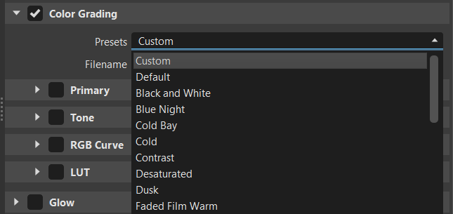

Presets - Provides an extensive list of presets.
| Default | Film Warm Preset |
Filename - Provides options for saving and importing color grading presets into your project. Click
to locate the file, which is stored here, C:\ProgramData\Autodesk\VREDPro-17.3\data\OpenColorIO\Presets, by default. Select the file and click Open. When using one of the provided presets, select Default.
To create your own presets, select Custom from the Presets option. Use the various color grading section options, then click the Filename
option to generate a .json file, which can be exported and shared with others or used in other scene.

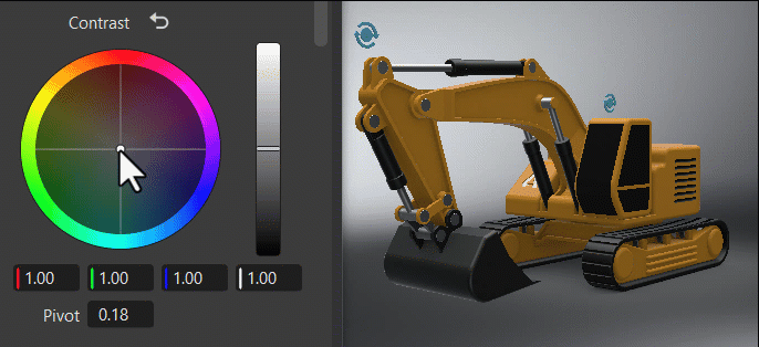

Each section contains several new controls, including color wheels, vertical sliders, and a new curve editor, to help you fine-tune the color balance of your rendering that are grouped within a frame.
| The color wheel controls within the Exposure frame |
Within the color wheel, click-dragging the center control toward the edge to adjust the grading, increasing the tint and intensity. This slowed mouse movement is intentional, as it provides more granular control in a relatively small control field. Clicking a specific location instantly jump to that position.
The vertical slider to the right of the wheel is the main control. For example, dragging the Contrast main slider up would increase difference between the brighter and darker parts, sharpening the entire image; whereas dragging it down would decrease the difference, softening the entire image.
The fields below the color wheel display the color transforms made in the color wheel, representing the individual RGB and Luminance values.
Clicking
, found next to the frame title, reverts all color wheel controls for that frame to their original default state.

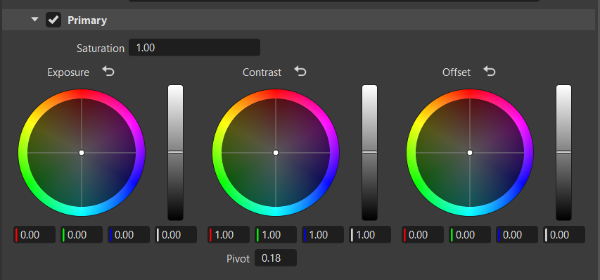

The Primary frame offers color wheel controls to allow broad adjustments made to the overall image. This includes adjustments to the entire image's saturation, exposure, and offset.
The Saturation slider adjusts the intensity and vividness of the image colors. Increasing the saturation makes colors more vibrant, while decreasing it brings them closer to black, white, or gray.
The Pivot adjusts the contrast balance and location of the center point used for making changes. Use it to fine-tune your contrast adjustments. Increasing the pivot value, darkens the image, while decreasing it brightens it.

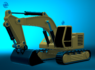

The Tone frame changes the image's color tone, helping to establish a mood or visual tone. Use the controls to color your blacks, shadows, midtones, highlights, and whites.
The S Contrast is a contrast curve. Use it to increase the image's contrast by darkening shadows and brightening highlights.
The Start and Width sets the range used for the contrast between the deepest blacks, modtones, and brightest whites. The higher the value, the larger the dynamic range.

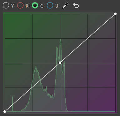

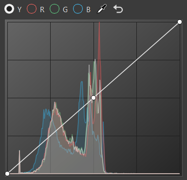

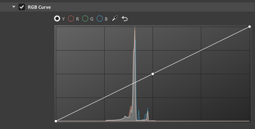

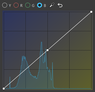

The histogram is purely based on the rendered image before any tonemapping or color correction. Its grading curves update as you move the camera around.
Along the top of the histogram are the following options:
Y for selecting luminance curve
R for selecting red curve
G for selecting green curve
B for selecting blue curve
for picking a color from the viewport and adding a new control point to the curve
for returning fields to their default values
Click the curve to add a new point and increase the contrast or pick a certain color and add a point to the graph that explicitly affects that range.

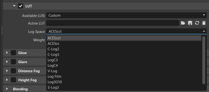

A LUT is a look up table that's used to tell VRED what color to make things. This can save a lot of time when color grading your content.
If rendering with HDR values, your LUT must work with logarithmic space and output to the same.

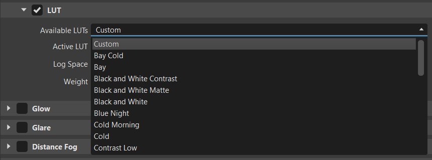

Available LUTs - Provides a list of LUT presets, as well as a custom LUT option.
| Bay Cold LUT | Vintage LUT |
Active LUT - Displays the current active LUT and provides options to open, import, save, update, or remove a LUT.
Log Space - Provides a list of logarithmic spaces to be applied to the LUT.
Weight - Sets the influence of the LUT on the overall color grading of the image.
| As the Weight value is decreased, so is the Active LUT's influence on the image's color grading. |
If a preset is selected from the Available LUTs list, it is automatically set as the active LUT. However, if you want to either load a custom LUT or import a shared LUT, use
. Locate and select the LUT, then click Open.
If you want to create your own LUT, select Custom from the Available LUTs list. Click the Active LUT
tool to locate a LUT, which is stored here, C:\ProgramData\Autodesk\VREDPro-17.3\data\OpenColorIO\LUTs, by default. Make mofications to it using the assorted options in the Color Grading section. When finished, click
, rename the file, and click Save.
